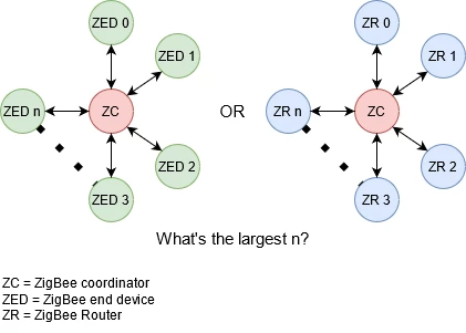

For STM32WB, in a centralized (star topology) Zigbee network, how many end devices can a single router/coordinator maintain?

With a single router/coordinator you can maintain hundreds end device. You can look the application note AN5492, there is an example 400 nodes network, see page 47.

Hey, I appreciate the response and document reference but that doesn't quite address my question. In that network there's 1 coordinator and 35 routers. The situation I'm referring to is: given a single coordinator (acting also as a router) what's the maximum number of devices of a single type (whether it's end devices or router devices) that can be connected to it? I'll attach an image of the possible networks: 0693W00000SwDhBQAV.png
