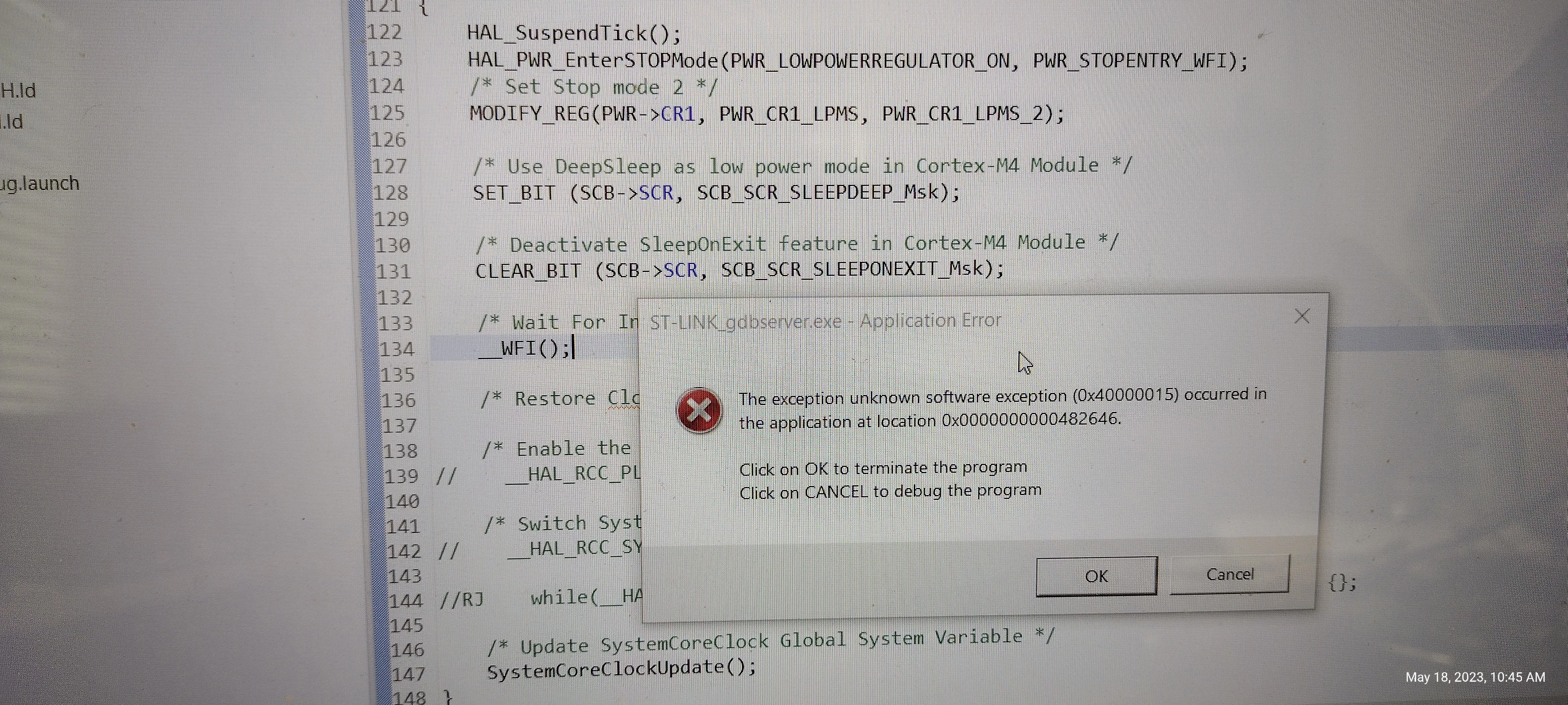

Bought a new STM32WB55RG development board, created a sample code on STM32CubeIDE V1.12.1, compile good in IDE. ( using Windows 10)
But when download to the board by click the RUN button, it will pop up Error screen - The exception unknown software exception (0x40000015) occurred in the application at location 0x00000000000482646.
Created another example code, it had the same issue..

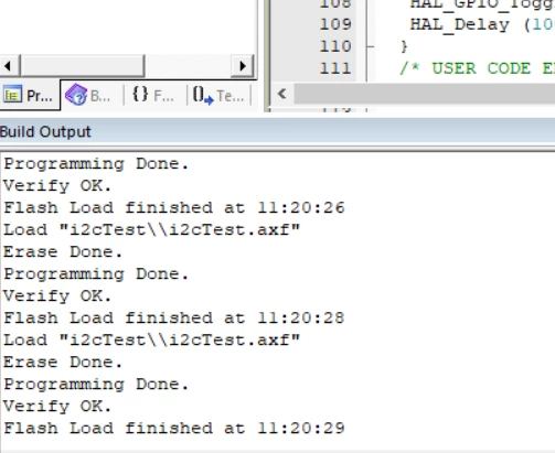

The board connect OK to Windows PC USB. I try another code and run on Keil, it does able to download. So I think the board itself is good, only the setting of the CubeIDE issue.

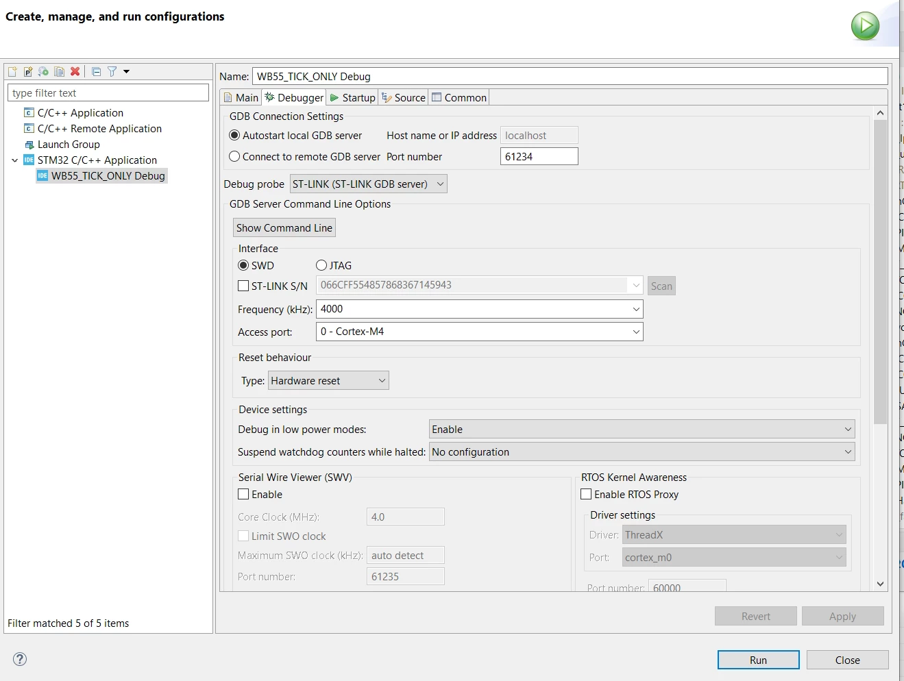

Hello @MLy.1
Could you please provide us a screenshot of debug configuration ?
Thanks,
Wijeden.

Hi Wijeden,

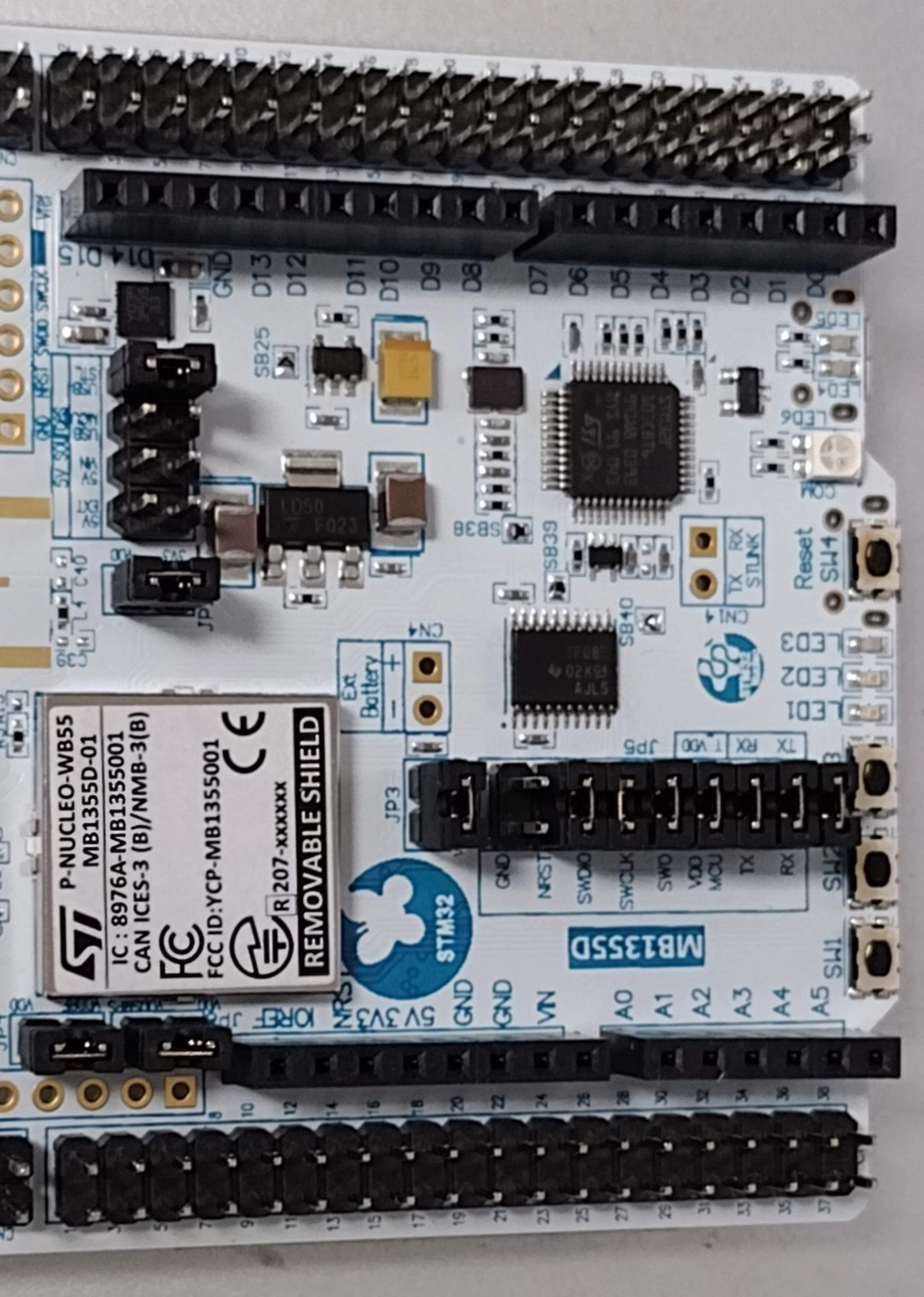

Here is the debugger setting screen and the jumpers setting on the board.
Thanks!
Martin

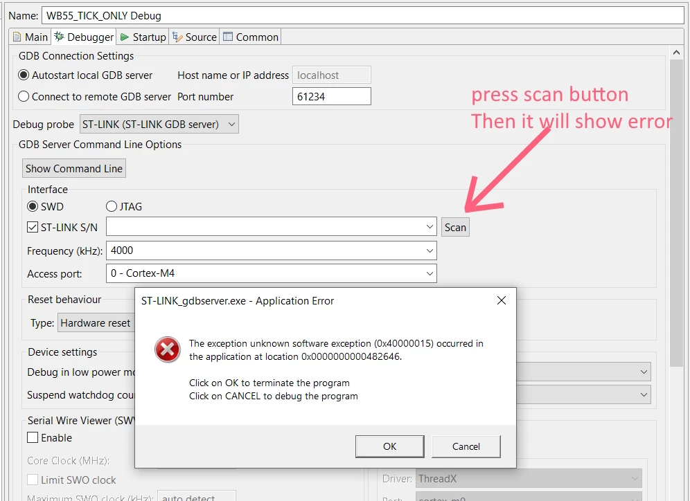

If I press "scan" button in the debugger setting, it will show the same error. Then show "fail to list debug probes" . Is that mean the port of the board is dead?

However, if I download code from Keil, the LED6 on the board will blink green & red and then download done. That also mean the USB port is good.
So I am confused.
Is that mean the setting of the CubeIDE has something wrong?
Thanks!
Remy ISSALYS
May 22, 2023 9:46 AM UTC
You can have a look to examples available in STM32CubeWB package and compare the setting with your project.
Best Regards
