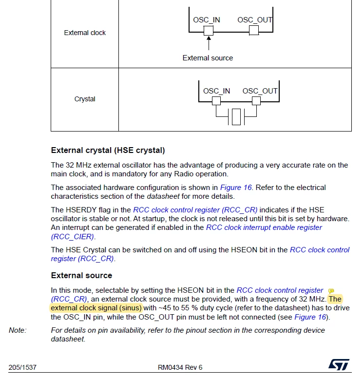

Another question: In the reference manual RM0434, it is specified, that an external clock has to have a sinus signal. I haven´t found many external clocks with a sinus. 99 % of them have a rectangle. If I use the MCO (master clock output) to output the clock of the external crystal, I also see a rectangle in the oscilloscope.

  • Does the MCO show the exact waveform of the input signal? Or to be more precise, does the NX2016SA generate a sinus signal?
  • Is it true, that an external clock for the HSE would have to be a sinus signal? That would limit the available products to ~1 %.
  • Is it generally recommended to use an external clock instead of the oscillator or are the downsides so bad, that nobody does it?
no. its sqw.
no. generates nothing - its a crystal.
no. see ds ->
i use most times an ext. clock oszillator, nothing to worry about tuning caps etc. . ymmv.

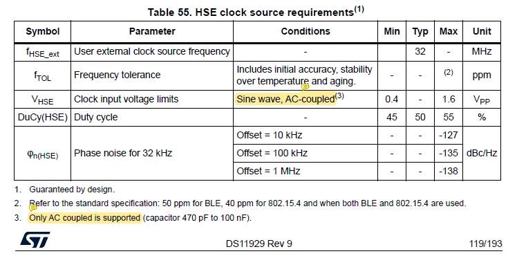

Thanks for the information! Yes, a crystal does not generate a signal by itself but is used as a part of the oscillation circuit and driven by the microcontroller to generate an oscillating signal . Is this signal square wave or sinus?
Regarding the requirement for the HSE signal: I was using an older revision of the datasheet. Interesting how things change. 1,6 V (max.) Vpp means a signal from 0 V to 3,2 V (max.) should suffice, right? I would probably go for 3 V as voltage, because this is the voltage I use for the microcontroller.
no - is too much.  give 1,6V vcc to the oszillator, then it will output 1,6vss sqw. , thats according to ds.
 10nf + 75 ohm in series , so its AC coupled.
