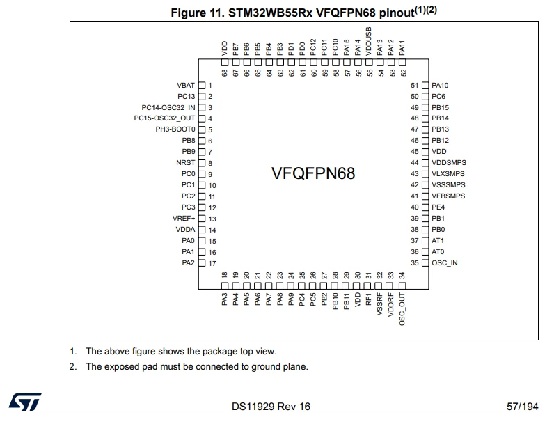

In my design I left the exposed pad in Stm32wb55rg VFQFN68 package. when I try to flash the device using st link , iam getting error "target not found". I am check the design and found i left the epad (69th pin) floating. Does this cause any issue ?. Please help me out here .thanks @Amel NASRI .

Hello @ajaykrishna097 and welcome to the ST Community :smiling_face_with_smiling_eyes:.
So, as indicated on the DS11929, the exposed pad must be connected to ground plane:
 So, for a working design, you need to connect the exposed pad to the GND plane.

Mar 1, 2024 10:21 AM UTC
Just to reconfirm, if I didn't connect the exposed pad to gnd then my design "will not work". Sorry for asking it again , if this is a issue that will for cause the MCU to not work, then I will redesign and initiate the manufacturing.
STTwo-32
Mar 1, 2024 12:36 PM UTC
To guarantee that the PCB will work on the best conditions, you should connect the exposed pad to the GND plane.
