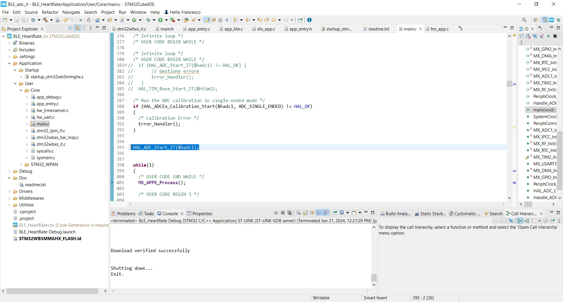

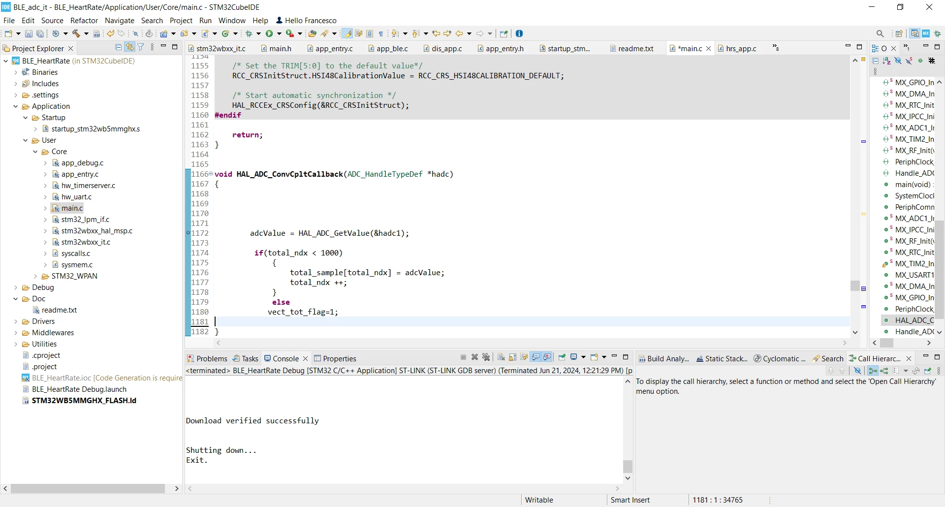

I have already tried... my problem is that I would like to know if I can use HAL_ADC_Start_IT(&hadc1) to acquire 1000 samples in my main independently of the sequencer and then when I have acquired the 1000 samples I send them. Only by doing this the simple callback in the main I can't even go in with the breakpoint because the sequencer starts immediately. How can I do it

What I suggest you is to look at the implementation of this wiki and try to add the ADC acquisition and send the same way as the implementation of the notify will sending pushing the button sw1 on the sequencer.
