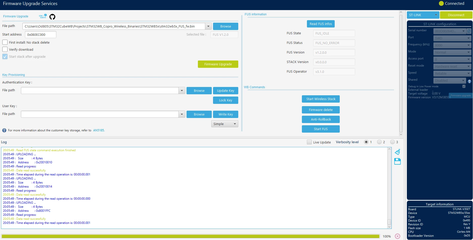

I am trying to perform a firmware upgrade but I keep receiving an error message Error: Rollback to older version of FW detected and not allowed!
Is there a way to get around this error? I have added a photo of the stm programmer page.
Additionally - can someone please confirm the order of performing an update? Should it be as follows?
Upgrade with stm32wb5x_FUS_fw_for_fus_0_5_3.bin
Upgrade with stm32wb5x_FUS_fw.bin
Upgrade with (in my case): stm32wb5x_BLE_Stack_full_fw.bin
Can I just jump to upgrading with stm32wb5x_BLE_Stack_full_fw.bin without the previous two? Thanks a lot as this is really quite the challenge for me currently.

Hello @od805
I think you have activated the Anti-rollback without ensuring that a wireless stack is correctly installed. If so, the FUS registers 0xFFFFFFFF as the new version, and it is not possible to install a wireless stack. For more details about Anti-rollback activation, I suggest you take a look at the part 2.4 of the AN5185.
Best Regards.
STTwo-32
od805Author
Jan 23, 2024 10:11 PM UTC
So if this is the case is this board no longer usable?

STTwo-32Best answer
Jan 24, 2024 6:30 AM UTC
In this case the stack reference version is considered as 0xFFFFFFFF (while no stack installed and anti-rollback is activated), so no firmware update is allowed after that, and no recovery is possible at this point.
