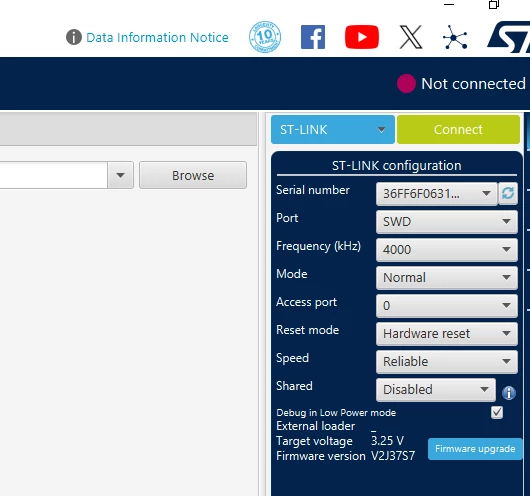

Error: No STM32 target found!
I think it is the most popular topic among STM32 programmers who use ST-LINK V2 programming devices.

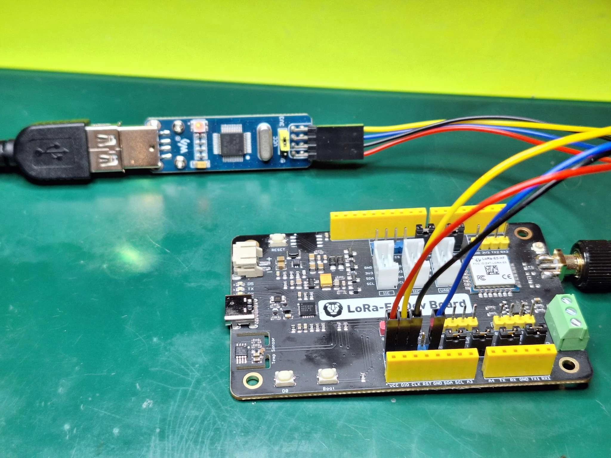

I have two devices: one is the Lora E5 MIni, and the second is the Lora E5Dev board. Both respond to the AT commands, so I expect they are healthy.
A few days ago, I could access these devices and see their memory. Today, I can't, and I don't know why.
I connected the programmer to the dev board as needed, and I can't connect to this device.
I tried to change settings as the other programmers suggested to achieve connection to such devices but without any success. Programming STM32 controllers using ST-LINK V2 is a kind of magic. It's a horror for me. I can't program my devices.
I upgraded firmware versions several times without any changes.

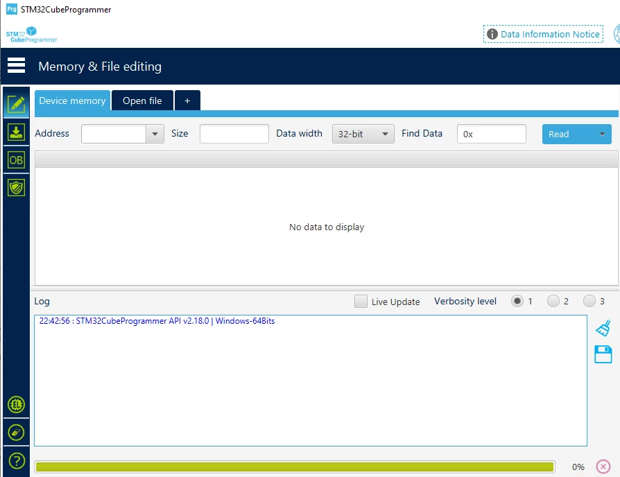

From the ST-LINK, it looks as expected, I think:
As I wrote above, changes of modes and reset modes gave no change.
So, what is wrong? ST-LINK answers on connection, but why it doesn't see devices connected to it?

Andrew Neil
Jan 6, 2025 5:47 PM UTC
Please post the error log from the CubeProgrammer.

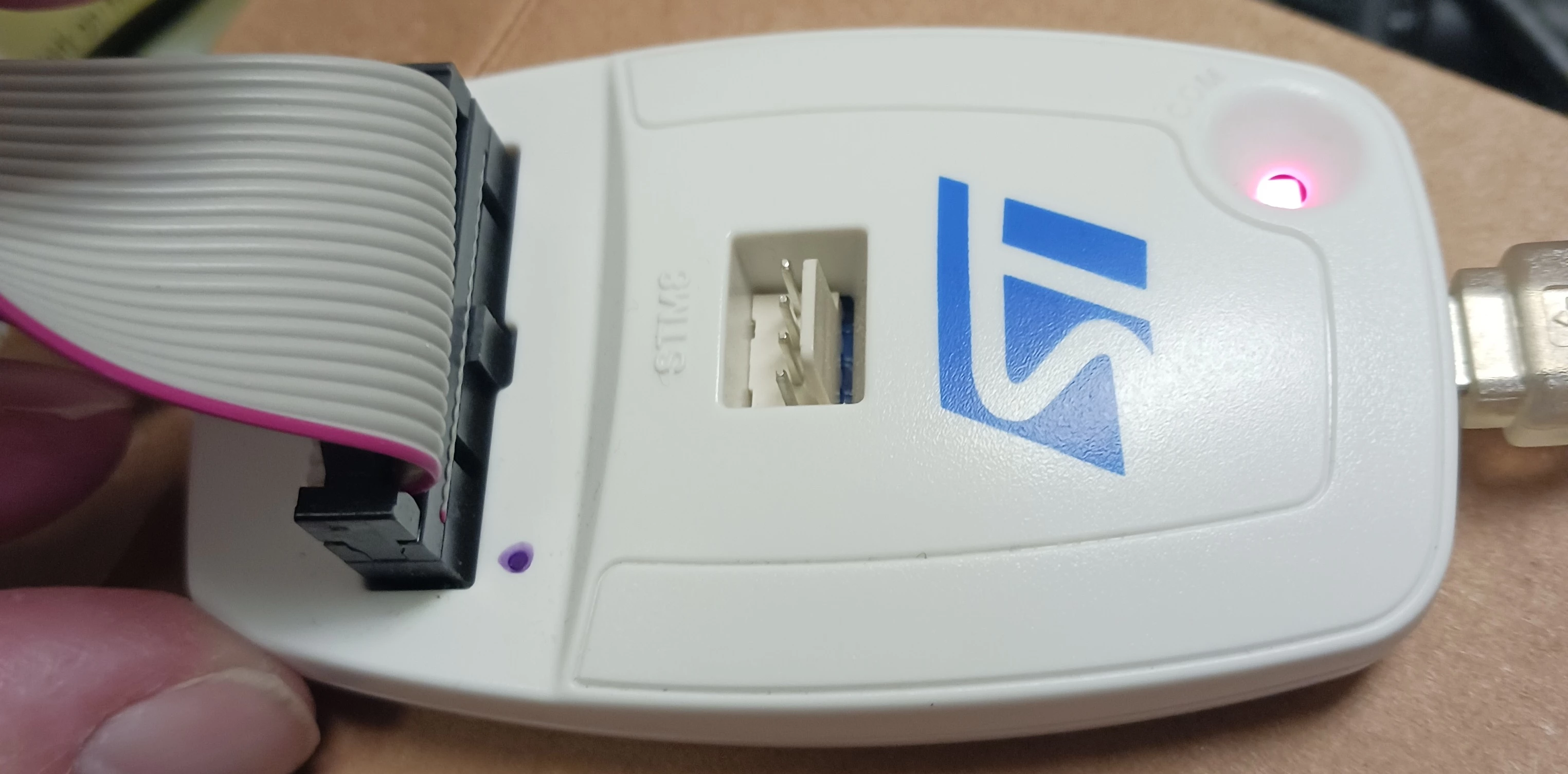

What you show in the photos isn't a genuine ST-Link from ST.
Have you tried with a genuine ST-Link?
Can your "ST-Link" connect to any other STM32 board(s)?
Can't make out what are the connections from the photos - please show a schematic.

@Andrew Neil : there is a sample log:
19:27:25 : UR connection mode is defined with the HWrst reset mode
19:27:25 : Error: No debug probe detected.
19:27:34 : UR connection mode is defined with the HWrst reset mode
19:27:34 : ST-LINK SN : 36FF6F063146503236522143
19:27:34 : ST-LINK FW : V2J37S7
19:27:34 : Board : --
19:27:34 : Voltage : 3.26V
19:27:34 : Error: Unable to get core ID
19:27:34 : Error: No STM32 target found! If your product embeds Debug Authentication, please perform a discovery using Debug Authentication
19:59:10 : UR connection mode is defined with the HWrst reset mode
19:59:10 : ST-LINK SN : 36FF6F063146503236522143
19:59:10 : ST-LINK FW : V2J37S7
19:59:10 : Board : --
19:59:10 : Voltage : 3.26V
19:59:10 : Error: Unable to get core ID
19:59:10 : Error: No STM32 target found! If your product embeds Debug Authentication, please perform a discovery using Debug Authentication

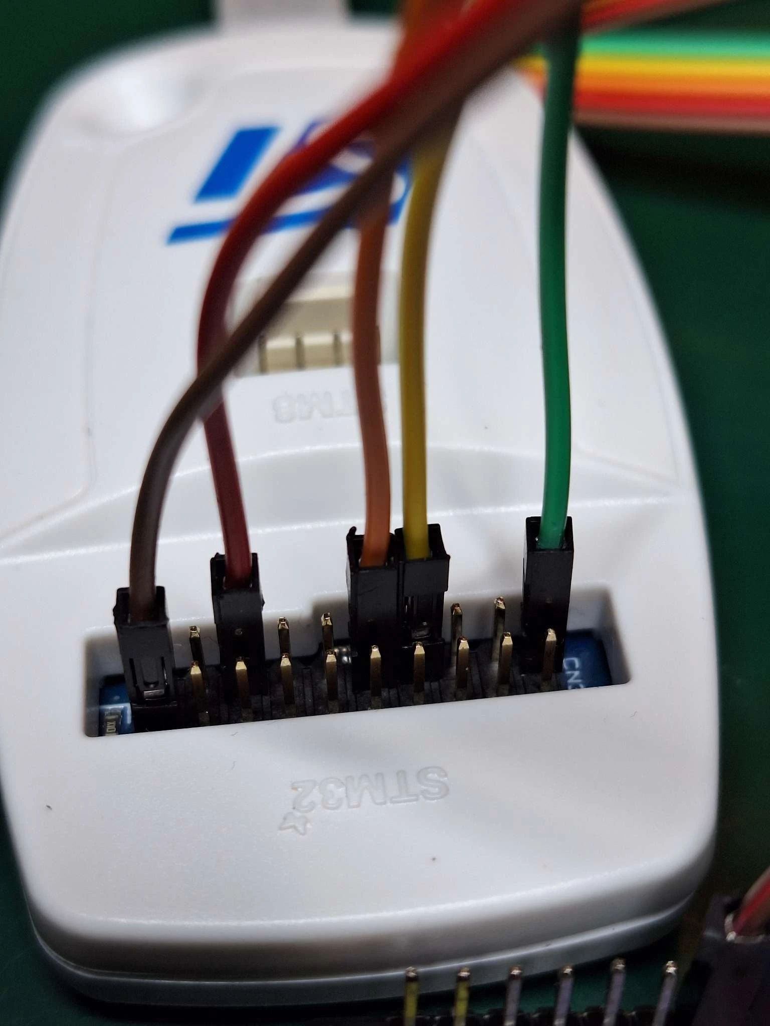

@Andrew Neil, I had a genuine ST-LINK V2, but it stopped working, so I gave it away.
So I bought another from VaweShare. It worked for several weeks, but it stopped working today.
I checked wired connections many times. All looks well.

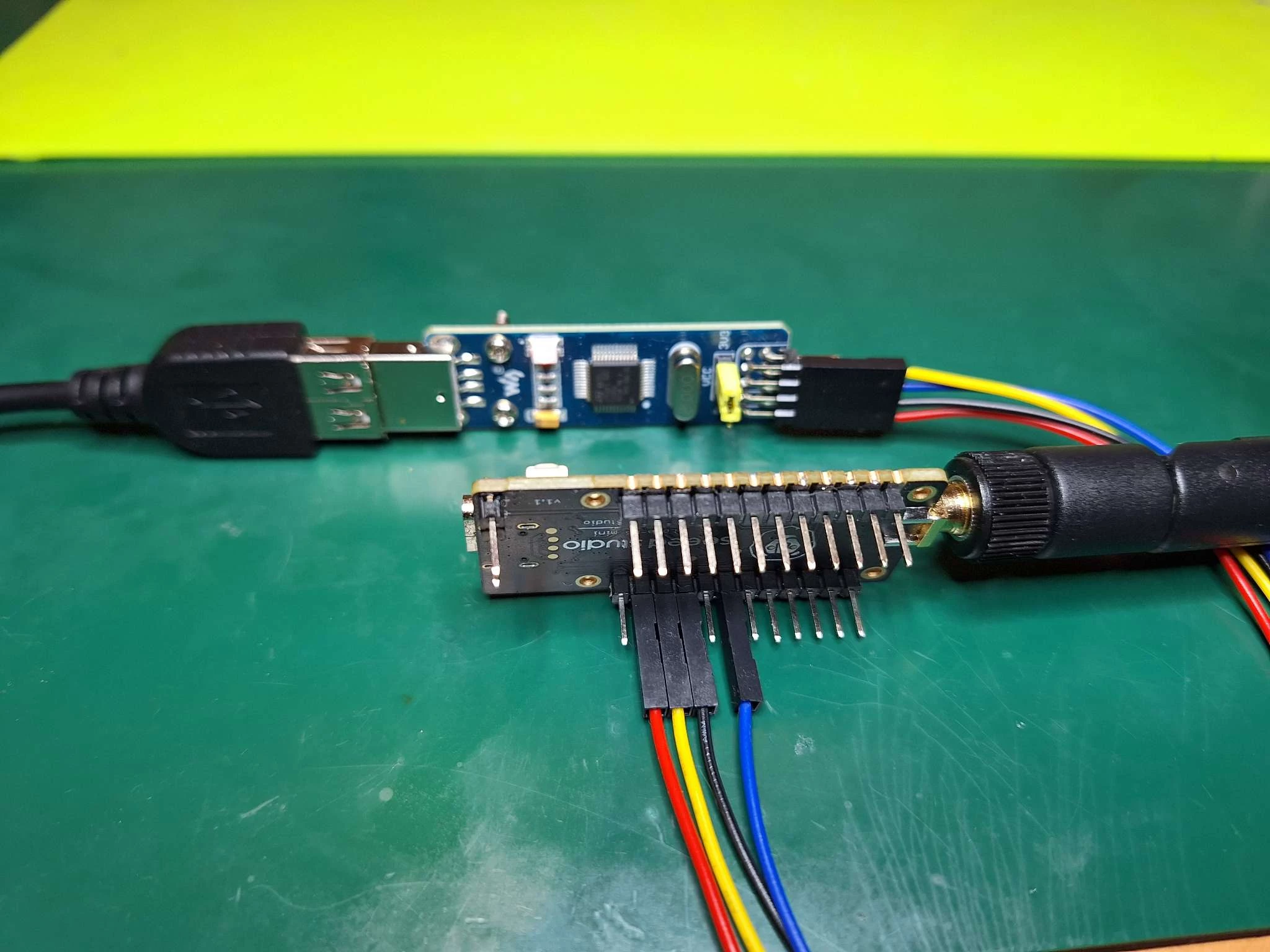

For both devices (Lora E5 MIni and Lora E5 Dev Board) I have the following wire connections:
From the ST LINK V2 (mini) I have the following pins:
VCC
GND
SWDIO
SWCLK
On the Lora E5 Mini I connect them to as usual:
V3.3 <- VCC
GND <- GND
DIO  <- SWDIO
CLK <- SWCLK
The same connections were for the Lora E5 Dev board.

markpow
markpowAuthor
Senior
Jan 10, 2025 10:18 PM UTC
To be honest, it's driving me crazy.

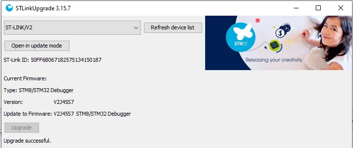

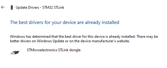

I bought the new brand ST-LINK V2. I upgraded it successfully:
The driver to it is actual:
I use the ST32CubeProgrammer:

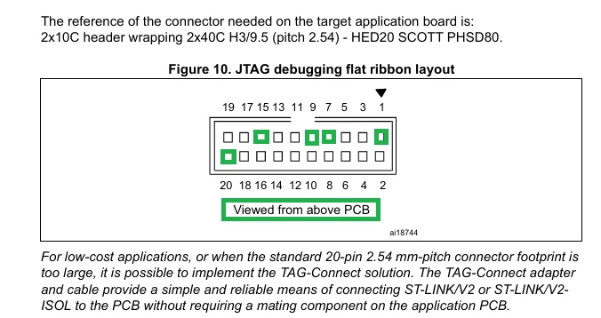

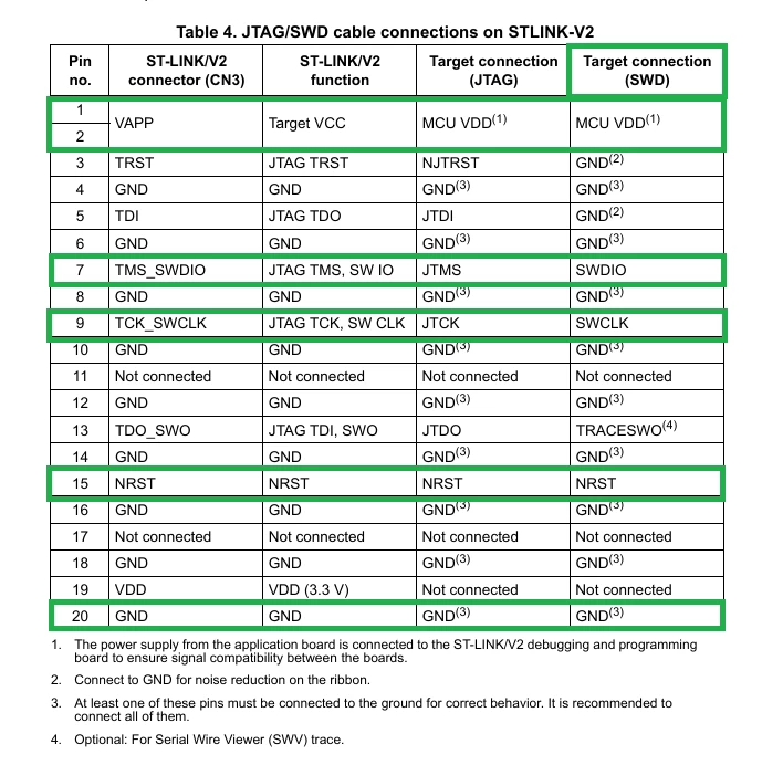

I've got pinouts for this programmer from the official link:
According to the above document, the order of the pins looks like this:

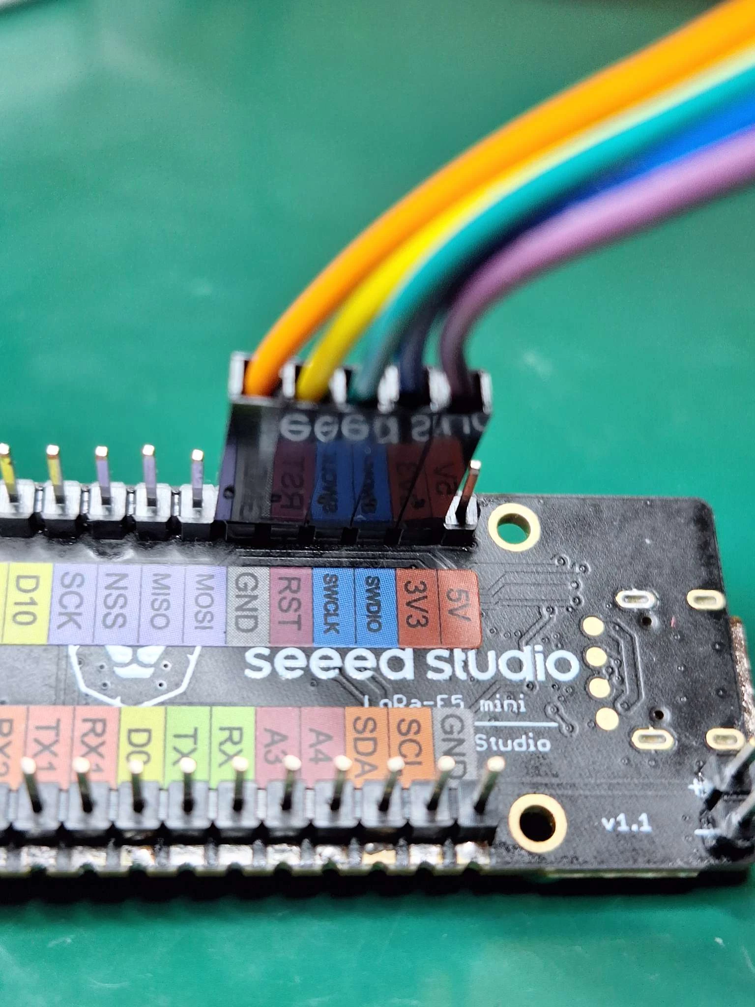

So I connected wires to the Lora E5 Mini:

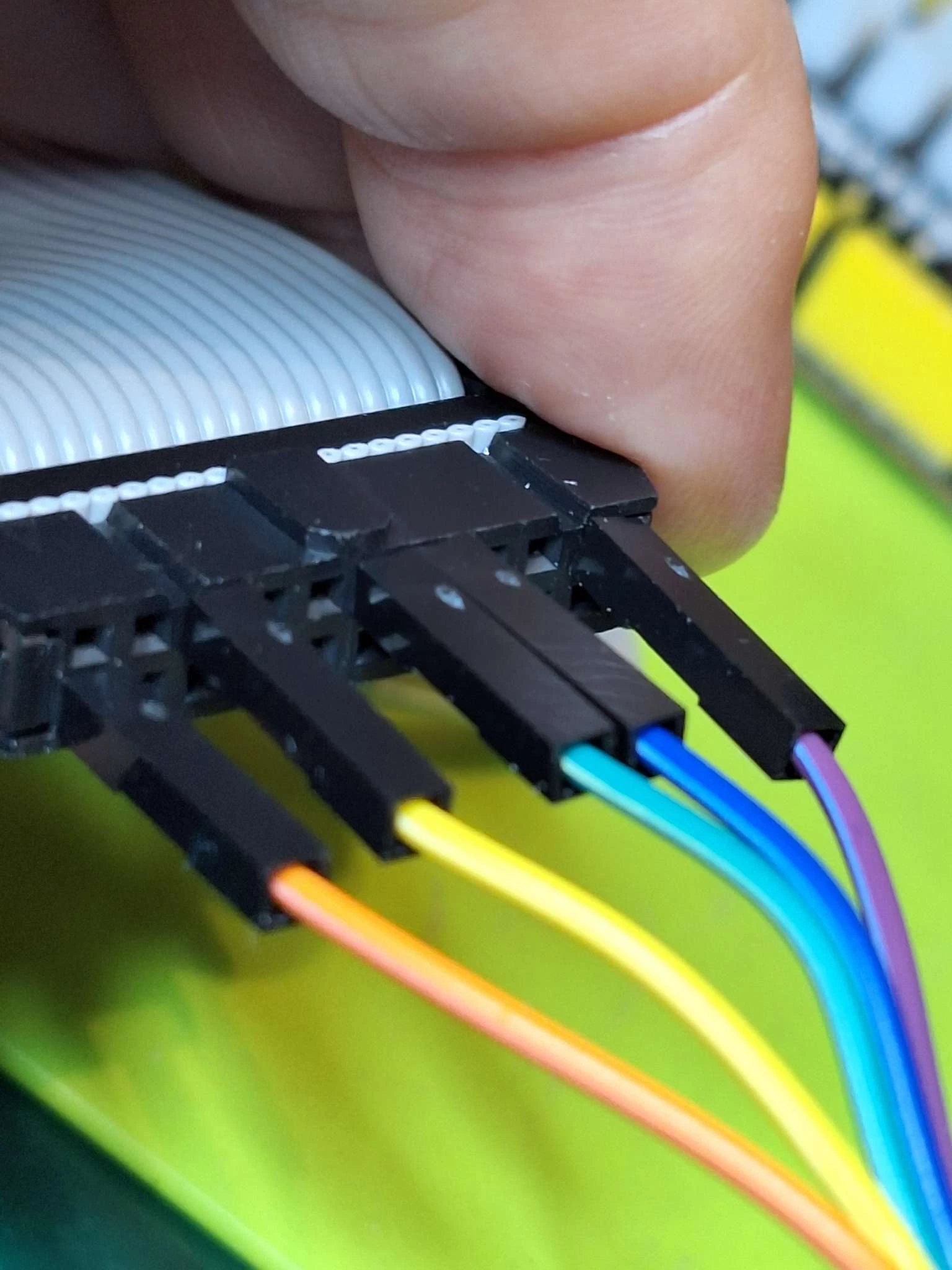

And to ST-LINK V2 (from the point of view the ribbon):

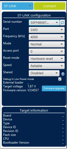

I have got the the result:
So nothing changed:
Next, I connected wires from the point of the pins on the board:
Connections to the Lora were the same as above (the target voltage is 0V in this case).
So I'm still at the same *** point.
So if there's no change, maybe the problem is at another point?
Is it possible that the problem is on the STM32CudeIde configuration or something else?
Three weeks ago, it simply worked, and after something happened, I can't program devices now.
Who can help me and point me out where I'm wrong?

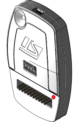

Tesla DeLorean
Guru
Jan 10, 2025 10:38 PM UTC
Both those connectors to the ST-LINK look backward.
Look at the diagram again
Pin ONE is the RED DOT, and RED LINE on the cable
markpow
markpowAuthor
Senior
Jan 10, 2025 10:50 PM UTC
Look at the last picture of my last post. I made the connections assuming that the first pin is in the right upper corner. The second is in the row below. Ans so on.
So exactly the way as you point out. Am I wrong?
