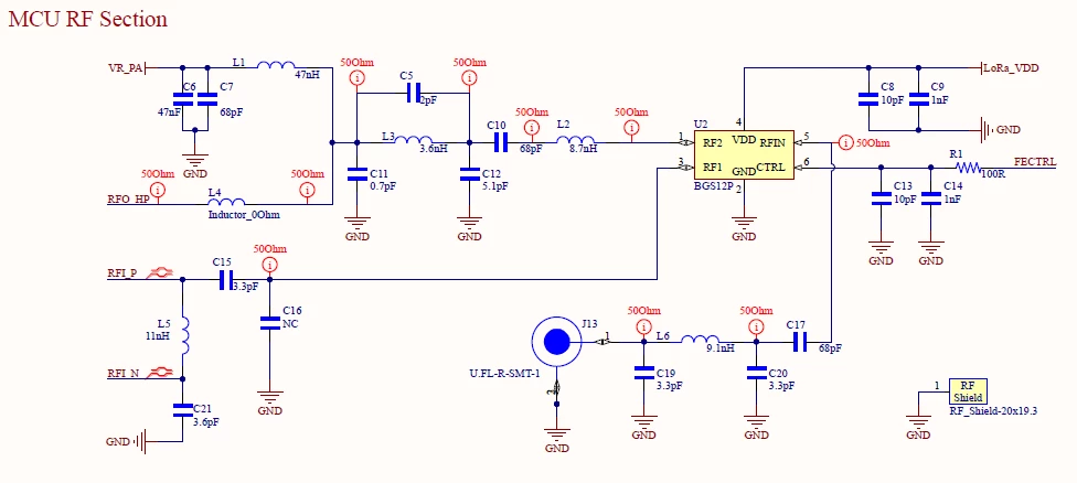

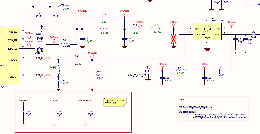

Hello Community,
I have made a custom board for the LoRa application for both P2P as well as LoRaWAN modes. The reference for the RF network I referred to is "Highband High Power" from the MB170 schematic. The frequency I am making this module is EU868 and high power. Below are the images of the MB170 and my board RF network.
While testing my board with Nucleo-WL55JC1 in P2P mode, the error is coming in receive mode. Also in transmission, when I transmit some message at receiving node (Nucleo-WL55JC1) RXP2P ERROR message is shown.
Are there any changes in the RF network value that will give me a fruitful result?
