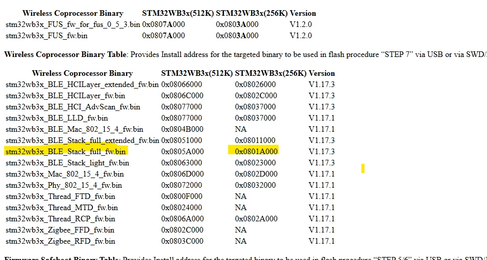

I am trying to upload BLE stack on my custom designed board. The MCU is STM32WB35CCU6A.
Below is FUS Version, I am able to get from MCU.
but when I try to upload BLE stack , I see below error.
Error: FUS_STATE_IMG_NOT_FOUND: Firmware/FUS upgrade requested but no image found. (such as image header corrupted or flash memory corrupted).

Hello @Nico3
Could you try to update your stack using the .bin stack file from the STM32CubeWB V1.21.0 and the last version of the STM32CubeProgrammer V2.18.0.
PS: install adresse is changed in this version. Don’t forget to Check the release note.

Thanks,,
Now I am able to install..  i did as u suggested.
Earlier I had copied binaries from somewhere else...
