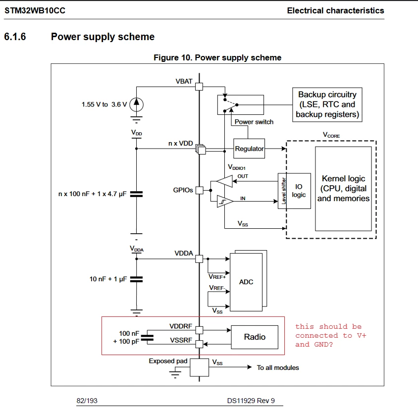

Error in Datasheet of STM32WB10
I just found an error in the data sheet and wanted to let you guys know. Don´t know who else to contact.

Hello @RWeil.2

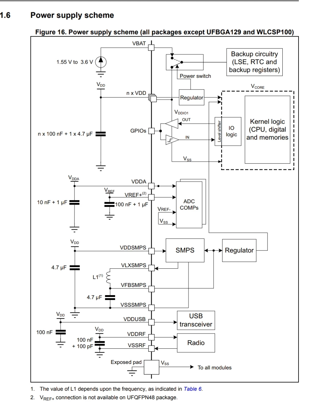

I can confirm the error in the figure 10 of the STM32WB10 datasheet. They should add a vdd and a ground to the radio power supply:
as in the datasheet of the STM32WB55:

Hello @RWeil.2, @Issamos,
Thank you for having reported this issue.
An internal ticket (ID 161429) is submitted in order to correct the document.
PS: ID 161429 is an internal tracking number and is not accessible or usable by customers.

DS13259 is the datasheet of the STM32WB10CC. But, ID 161429 is the reference of an internal ST ticket that has been created to correct the DS13259 error.
