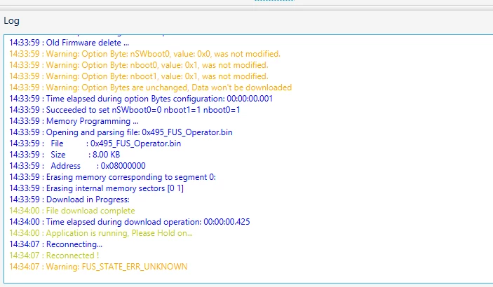

Error: FUS_STATE_ERR_UNKNOWN: Unknown error

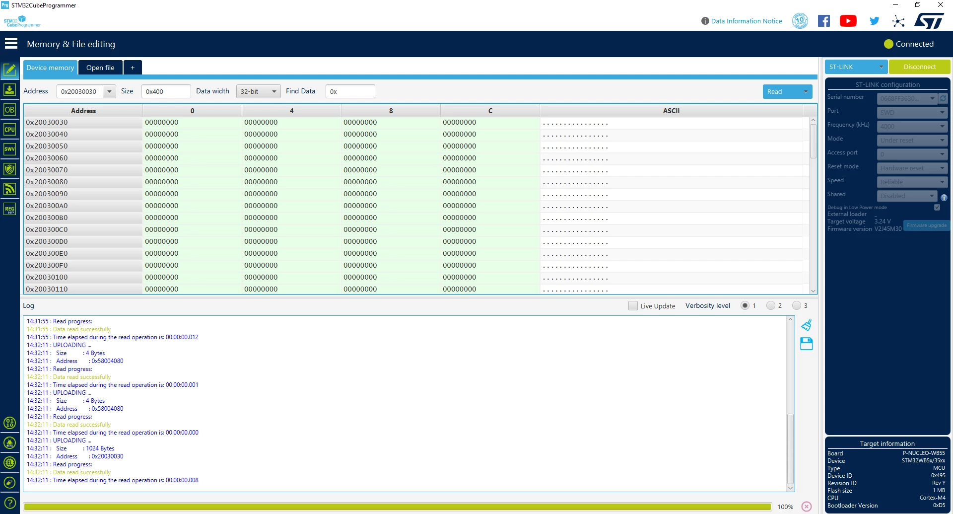

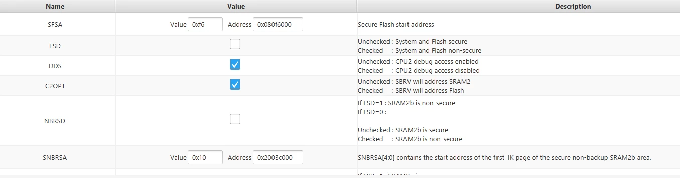

Hello, I am using a P-NUCLEO STM32WB Bluetooth 5 and 802.15.4 Nucleo Pack including a USB dongle.

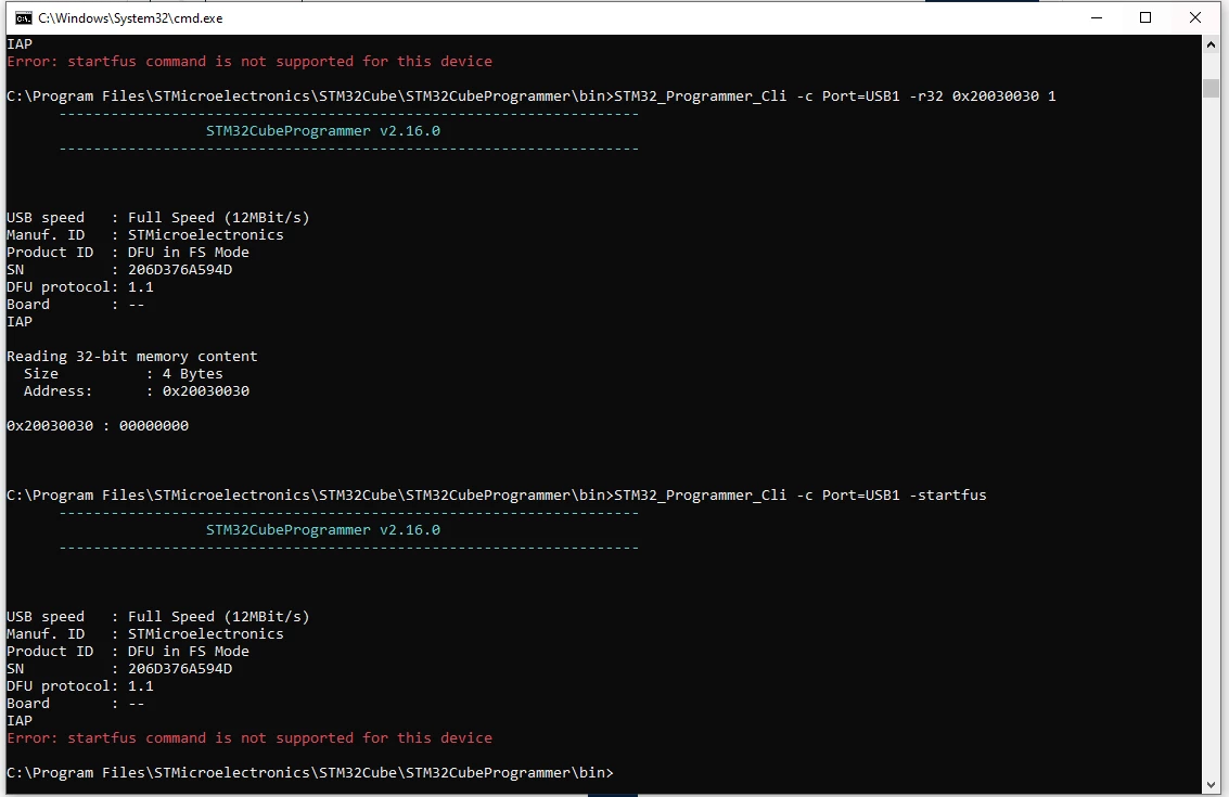

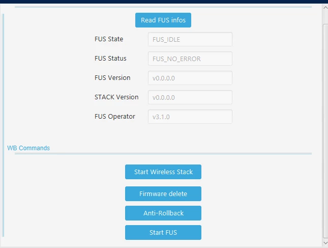

While trying to update the FUS of the USB Dongle to set up a Thread network, I encountered several errors.
Initially, I was able to connect in DFU mode, but after attempting the update, Windows no longer detected the USB dongle.
I then used the ST-Link to try to perform the update, but encountered these errors:
You can also find some informations related to the dongle.
Screenshot 2024-05-22 143244.pngScreenshot 2024-05-22 143334.pngScreenshot 2024-05-22 143537.pngScreenshot 2024-05-22 144025.pngScreenshot 2024-05-22 144225.pngScreenshot 2024-05-22 150936.pngScreenshot 2024-05-22 143009.png
Is it still possible to recover the USB dongle? Any help would be appreciated,

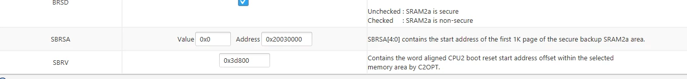

According to your screenshot, SBRV is equal to 0x3D800 that indicate FUS v0.5.3 is running on your board. So, you must update the FUS using the stm32wb5x_FUS_fw_for_fus_0_5_3.bin binary.
