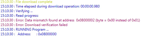

I'm using LoRa E5 mini board that has STM32WLE5 MCU on it.
I use STM32CubeProgrammer and the STlink of a Nucleo64 board to send the firmware to it.
For some boards, I cannot succeed to flash them and get this error :

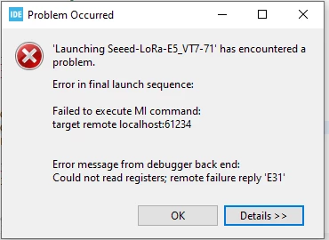

0693W00000Y8XmyQAF.pngWhen I try to use STM32CubeIDE I've got this error :
I already checked that OB RDP is AA.
By following the article of ST (https://community.st.com/s/article/Custom-external-loader-failed-to-download-segment-0) I try to use the 2.6 version of STM32CubeProgrammer but without any success...
When I increase verbose level on STM32CubeProgrammer I've got those logs :

I 've check cables external loader, and programmer configuration all seems good.
I've also contact Seeedstudio that build the board with the STM32WL in it.
It appear that there is some problems with those boards... They can be stucked...
Some of the boards can't be reach by the stlink (le power voltage drop to 1.2V)
Some of the boards can't be flashed correctly :
We've brought 100pc I really hope we will find a solution...

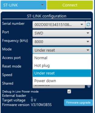

videojames
Feb 8, 2023 6:06 AM UTC
You can try flashing the boards with Under Reset mode, I have had some luck with this with a similiar error message.
However it does sound like Seeed may be the more appropriate location for support.
