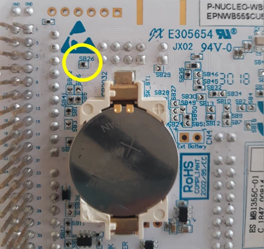

In the datasheet of P-NUCLEO-WB55, there is an information about Solder Bridge. Please see the attached pictures for more information. Do you think that's the solution? to make change on the Hardware and make SB26 ON?
Thanks again.

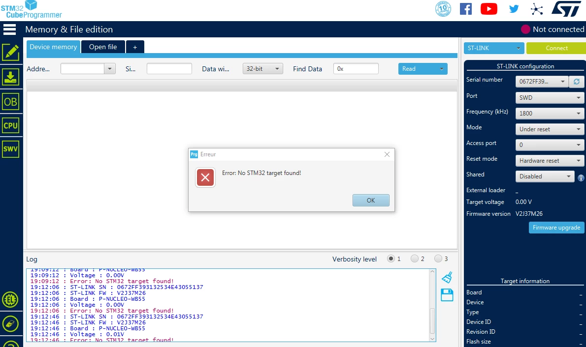

Hi @Remi QUINTIN​ ,
Thanks for your answer. Even with jupmer between oin 5 and 7 on CN7, it doesnt work. I try to use also CubeProgrammer, it cannot connect to the board. Please see the attached picture.
Please how can i; set nSWboot0=0 nboot1=1 nboot0=1 o be able to connect to the device?? Thanks for helping.

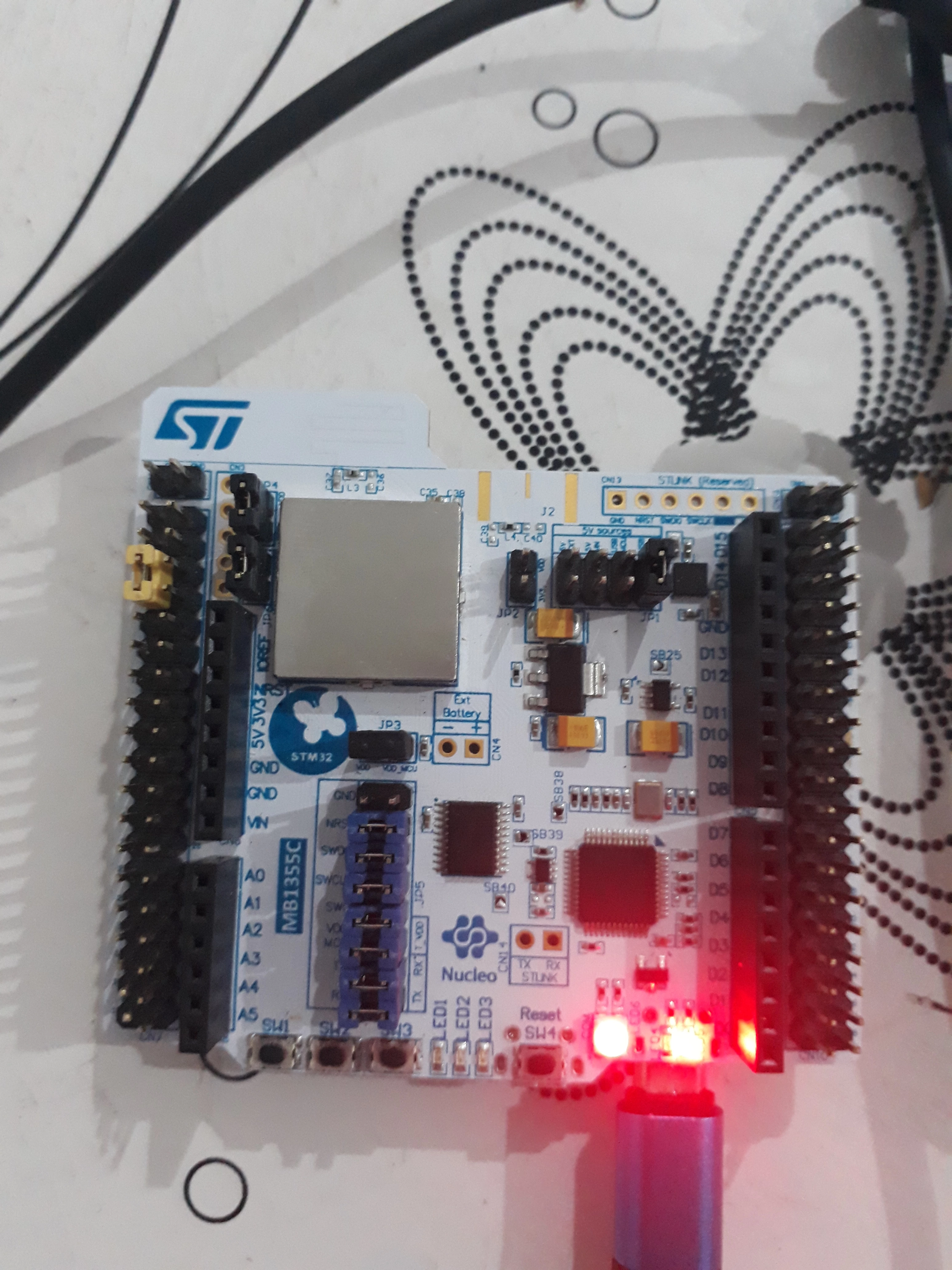

​Looking more carefully at the picture of your Nucleo board, I can see that all jumpers from JP5 are removed while there are all set on my nucleo bioard except the last one GND.
So you have the exact opposite configuration on JP5 vs mine. Check this point.

In fact, all jumpers of JP5 are connected! If you loook carefully, they are dark blue

Out of the box, everything works. So if I were you, @mmed​ , I would get a new, un-opened, STM32WB Nucleo dev kit, open it and handle it carefully so as not to zap it with static, and connect it with a new USB cable in order to get to a sane point of something working.
Remi QUINTIN
Nov 12, 2020 7:59 AM UTC
​Moreover, the shield over the WB chip seems to be a very old version.  There should be some information printed on it.
Where did you get this board? I would recommend also to try with another newer board.
