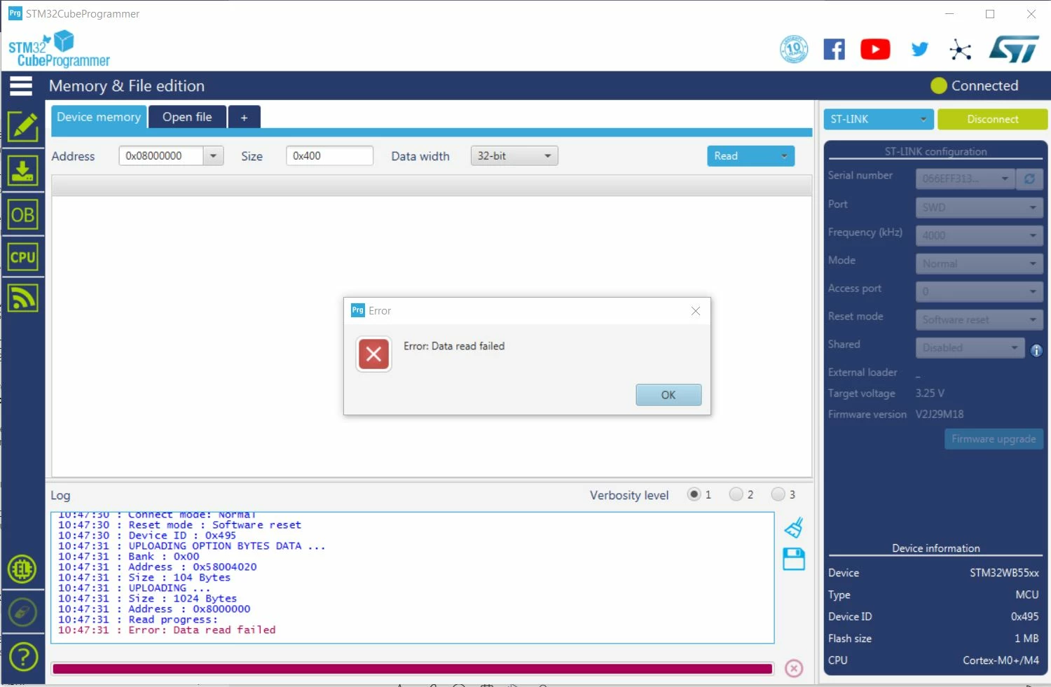

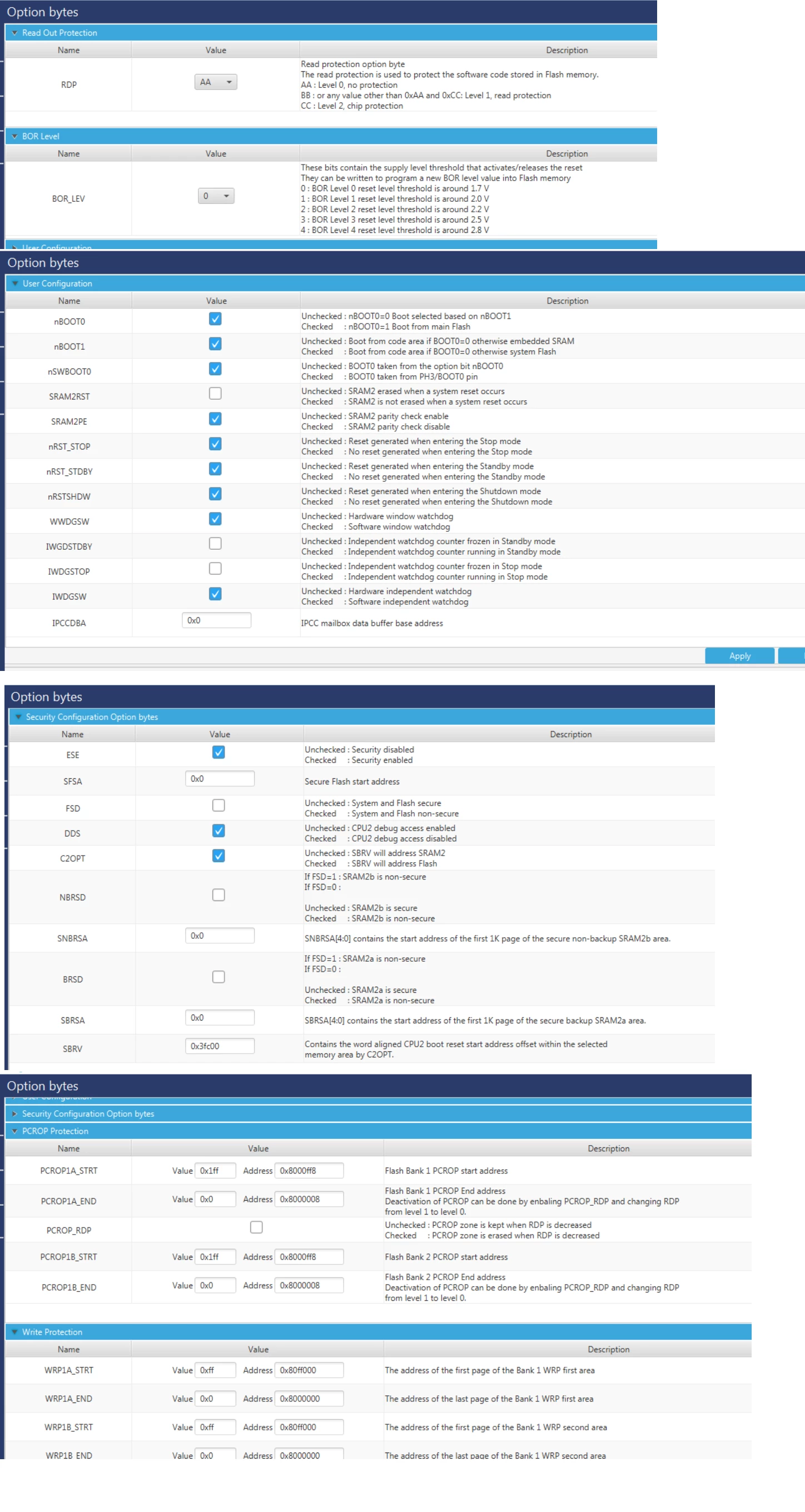

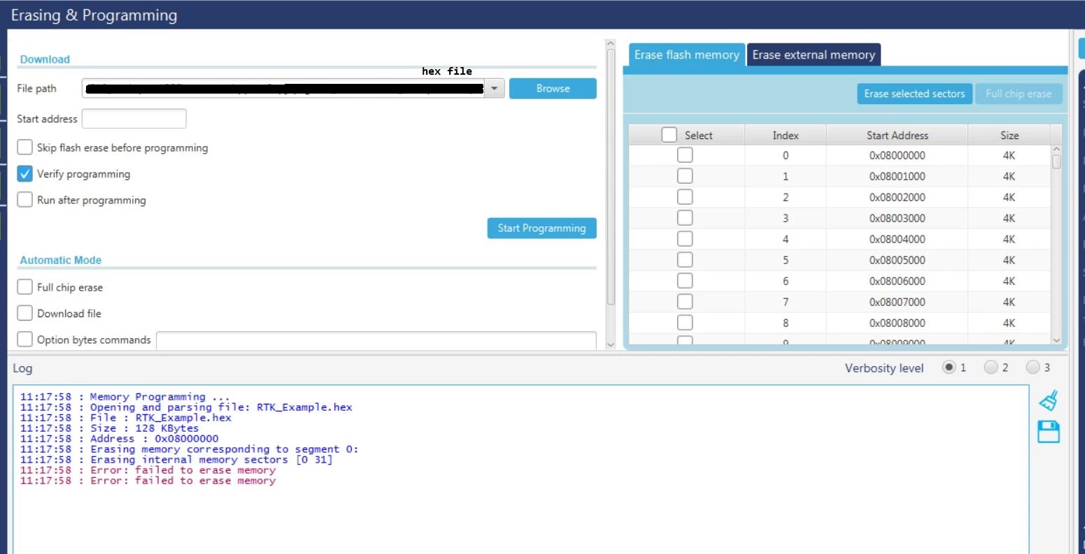

December 14, 2020
STM32 Cube Programmer Utility :
Snapshot of Error STM32 Cube Programmer : Connect event
I am able to read option bytes:
0693W000006FaFQQA0.pngBut I am not able to erase or download

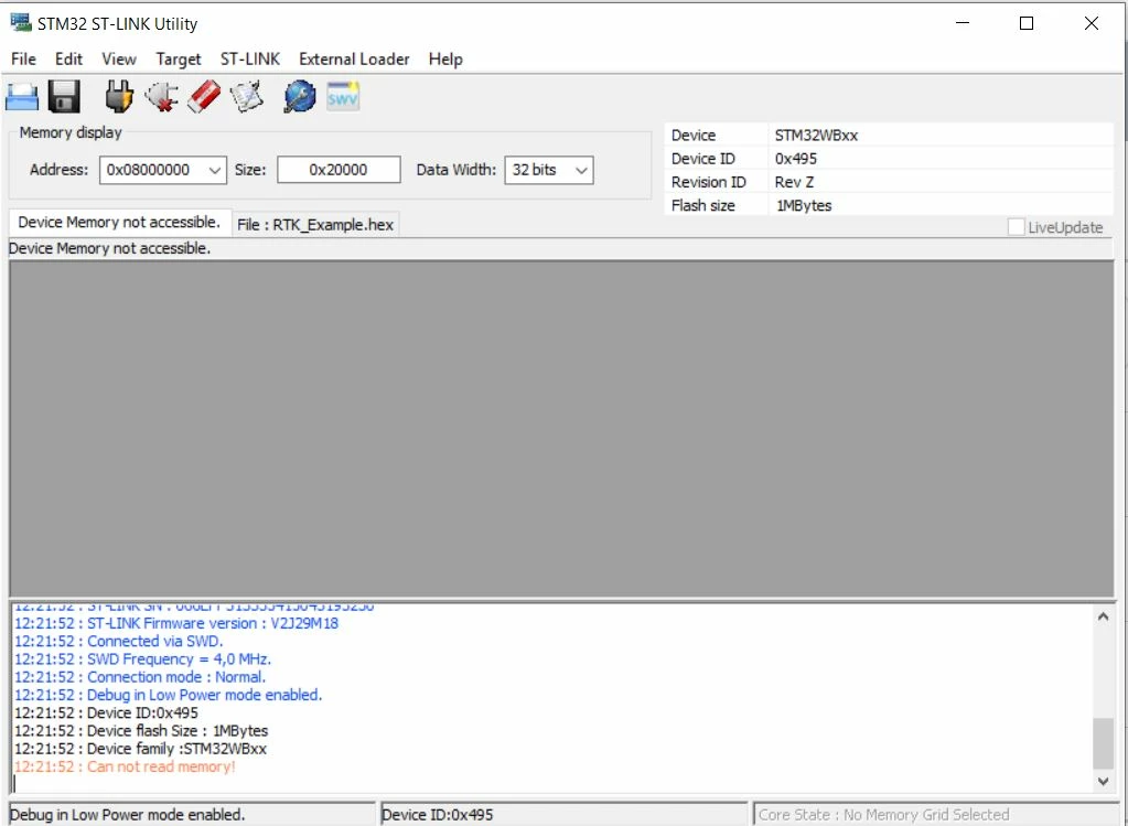

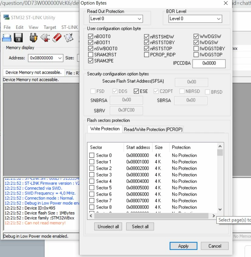

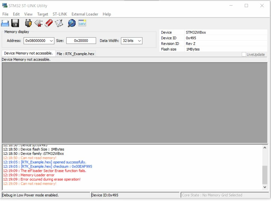

STLink Utility :
Able to connect but getting read error :
I am able to read option bytes :
0693W000006FaQEQA0.jpgError in erase and download :0693W000006FaQiQAK.jpg
