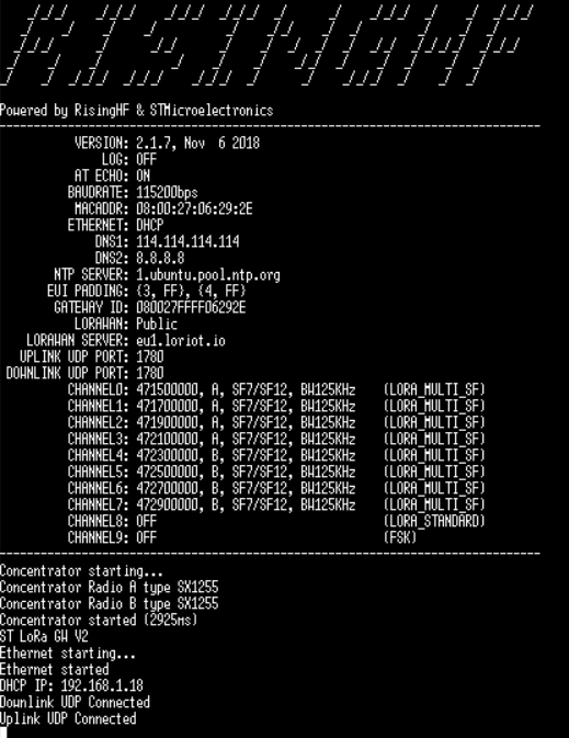

Could you send the trace of your Gateway. Also, do you have other nodes connected to this same Gateway.

for the nodes i only have the device that came with the pack and there is no other nodes connected to the gateway ,sorry i am new with the stm32 i hope you mean by trace this screenshot
thanks a lot.

Hello @Dan33
I think you should try to configure the gateway to use the same frequency as your end node CN470. Or change the end node frequency to be compatible with one of the gateway channels. This video should help you.
Best Regards.
STTwo-32
Dan33Author
Feb 24, 2024 3:13 PM UTC
acutely i did change the gateway to the same ferquency i use the CN470 for both but it kept the same and didn't join

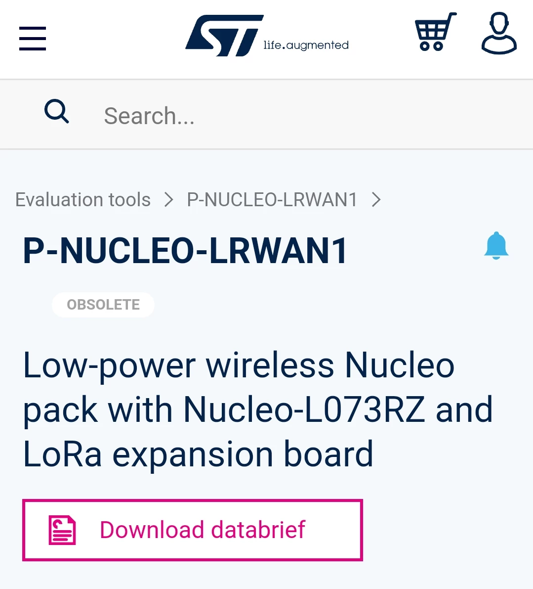

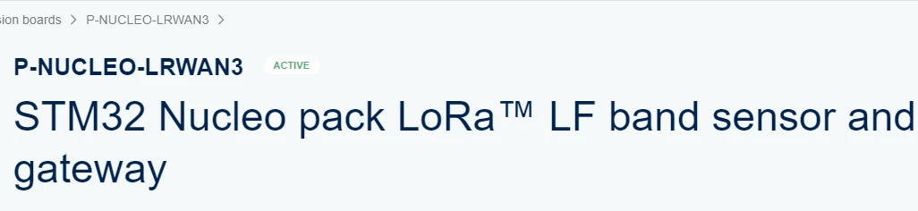

Andrew Neil
Feb 24, 2024 4:03 PM UTC
That's P-NUCLEO-LRWAN1
OP said P-NUCLEO-LRWAN3 - which is  marked as 'Active':
:thinking_face:

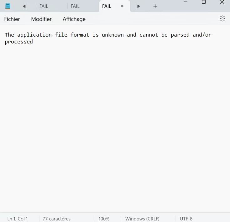

i have tried to load a simple blink led to my L0 and it work  but i have found a file .bin (rhf0m003-v3.5.13.bin) in the risinghf site and when i try to drag and drop it in the L0 it failed
is there any solution exept getting a new end node
In what way(s), exactly, did it "fail" ?
  • Failed to copy to the mass-storage device?
  • Failed to program the target microcontroller?
  • Failed to run after programming (give details) ?
  • other ?
Dan33Author
Feb 27, 2024 3:10 PM UTC
acutely i haven't contacted RisingHF Support but i found the file in here :https://www.risinghf.com/product/detail/19
and by it failed i mean it failed to copy to the mass-storage device
