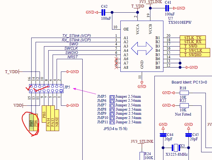

I i am trying to follow the AN5604 (STM32WB Series BLE interoperability report) but im unnable of enabling the debug UART.
Nothing shows up the Nucleo's stlink's COM port, but the programm is running, im able to conenct to the BLE device from my phone.
(on the PC side im using putty and realterm, and COM8 its the only COM port available)
CubeMX file attached

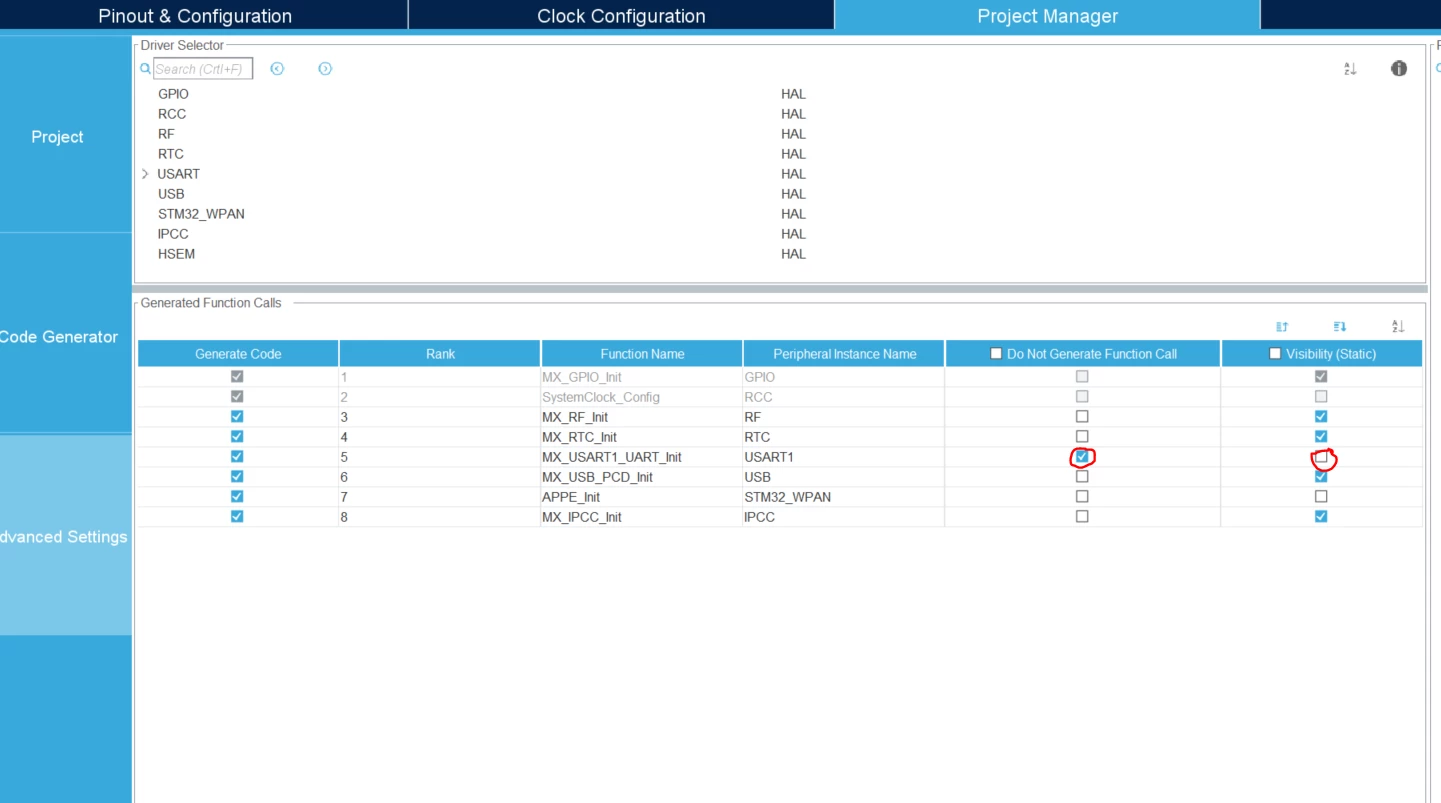

Steps i followed:
  • USART1 Mode Anynchronous with pins PB7 and PB6, hardware flow control set to CTS only0693W00000DmxqdQAB.png
  • CFG_HW_USART1_ENABLED set to Enabled.
CFG_HW_USART1_ENABLED CFG_HW_USART1_ENABLED
Parameter Description:
Enable or Disable traces USART1 (USART1 Mode must be set to Asynchronous with Hardware Flow Control set to CTS only)
Please ensure that in ProjectManager Advanced Settings panel MX_USART1_UART_Init Not Generate Function call is ticked and that Vibility is unticked

  •  Dissabling function call generation in cubeMx for uart1, also make it not static

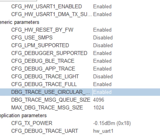

I started following another tutorial with another dev board and it works now, no idea why.
  • Usart1 was cofigured as asynchronous without hardware flow control.
  • DMA was assigned to USART TX
  • USART1 global interrupt was ticked
  • Inside STM32_WPAN/BLE/Configuration:
0693W00000FAgT6QAL.pngI attached the cubeMX config

I tried tying PB4 (UART1 CTS pin) to GND but no luck neither.
tried dissabling USB Device and Serial Wire debuggign to get rid of the cbeMx warning... still not working
