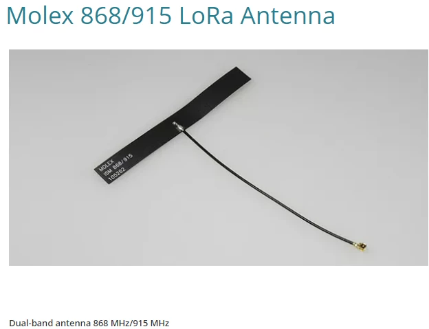

We would like to enable multiple regions. From the STM32CubeIDE we open the .ioc file, which opens up the configuration GUI. There we have the possibility of enabling multiple regions. We have chosen this antenna for the application.
Apart from the antenna, you'll also have to ensure that all the rest of your RF hardware (filters, etc) works within the requirements of all the intended bands.
