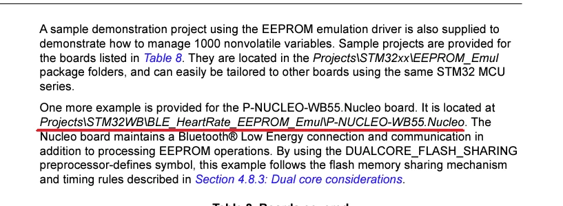

I`m working on a customised STM32WB55 board and trying to implement eeprom emulation.
According to AN4894
there should be a BLE_HeartRate_EEPROM_Emul example somewhere but looking at STM32Cube_FW_WB_V1.12.0 package I can`t find it. I have also checked the STM32 github page but still no chance . Has anyone have access to this example ?

    Hello @TGUCL.1
    The example exist in the X-CUBE-EEPROM Expansion Package. You can find it under: projects/STM32WB/BLE_HeartRate_EEPROM_Emul.
    PS: don't forget to read the readme file of the project before using it.
    Best Regards.
