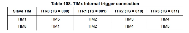

Does there exist an STM32WB5MMG reference manual?
I am aware there is a datasheet, but it does not contain the info I need. I am trying to configure timer triggered timers for my project, so I would like to know the internal trigger mapping for each timer. I am hoping to find something similar to the image below from the STM32F446xx reference manual. Any help is appreciated.

Hello @Lloyd44​ and welcome to the Community :),
The STM32WB5MMG based on the STM32WB55VGY microcontroller and shared the same reference manual (RM0434). Also, I advise you to refer to the errata sheet for the STM32WB5MMG.

From the web page and the datasheet:
"Based on STMicroelectronics STM32WB55VGY wireless microcontroller..."
