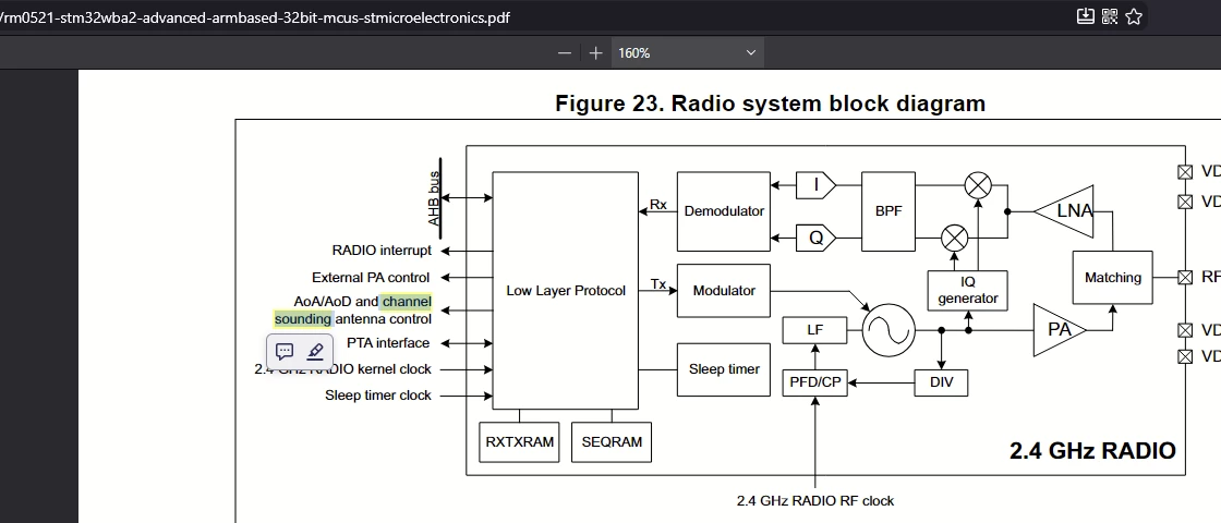

Jul 20, 2026 9:34 AM UTC
What about STM32WBA2x?
Documentation mentions it:
There is already example for AoA. But nothing about sounding.
Laurent LOUAZON
Aug 20, 2026 8:50 AM UTC
Existing STM32WBA2 does not support channel sounding.
As mentioned previosuly, some more STM32WBA2 parts should come soon with support of channel sounding. Stay tuned.
