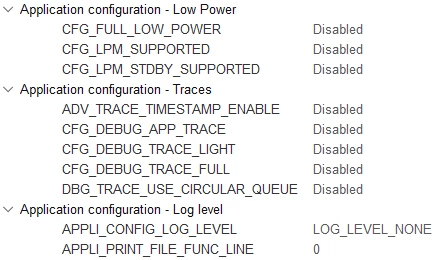

I'm using a STM32WBA52 for my application with necessitates three UARTs and the BLE Interface.
In my CubeMX configuration, I've desactivated any usage of TRACE or DEBUG, nevertheless, even in that case, when :
/* Init code for STM32_WPAN */
MX_APPE_Init(NULL);
is called, USART1 doesn't work anymore.
My configuration on CubeMX is :
If I unckeck "ADV_TRACE", the code doesn't compile anymore due to multiple rerferences to "stm32_adv_trace.h".

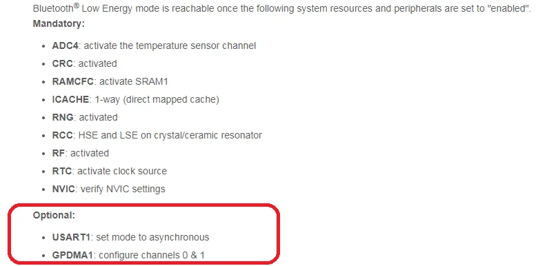

Is there any limitation of usage of u(s)art with the STM32WBA when BLE interface is enabled ?
When I read your doc (https://wiki.stmicroelectronics.cn/stm32mcu/wiki/Connectivity:STM32WBA_BLE_STM32CubeMX), however, it seems not :
Thanks a lot for your answers ... I'm a bit stuck at that point !!
