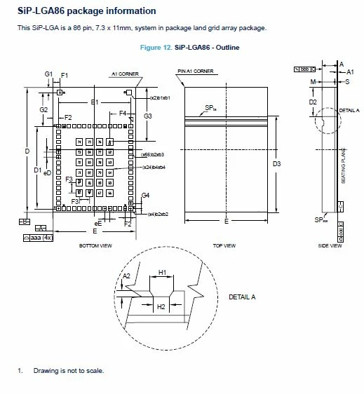

Does STM32WB have any PCB antenna module?
Hi Sir,
Like BlueNRG-2 have PCB antenna's of BLE232SA-A and BLE232UA-A Does STM32WB also have these kind of antenna modules???

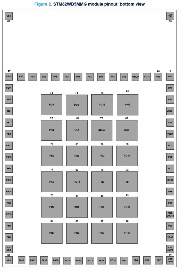

​Unfortunately, I do not have much information to give you.
All the documention will only be available at the time the modue is available.
I can just provide you the pinout if it may help.

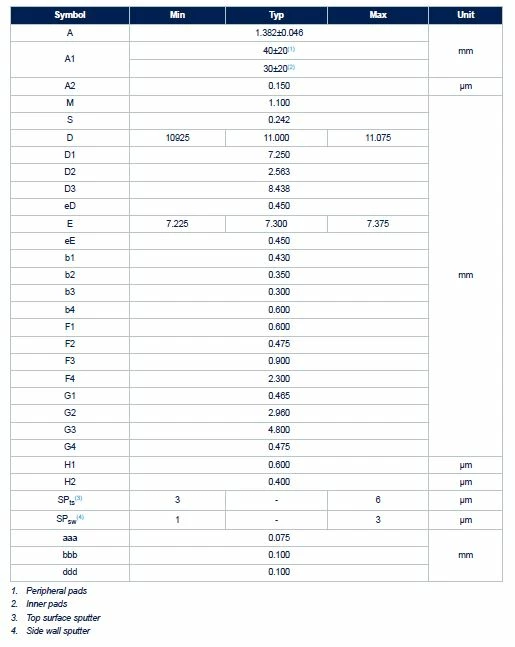

Thanks, I have see it is also available on the Cube. Can you please provide just the footprint so I can order the PCB while the component become avilable?
Remi QUINTIN
Nov 30, 2020 2:26 PM UTC
​Here is the footprint.
