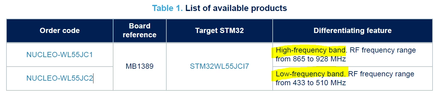

What are the physical differences between NUCLEO-WL55JC1 and NUCLEO-WL55JC2 Dev boards.
Is it possible to convert the NUCLEO-WL55JC2 to a NUCLEO-WL55JC1?
The NUCLEO-WL55JC1 seems to be unavailable on the market at this point.

The user manual describes the difference.
Both use the same MB1389 board, so presumably they can be converted given enough effort. The BOM is available for both variants.
