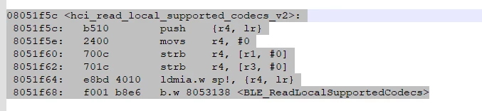

    I am using STM32WBA55G-DK1 board to develop ble audio device. When i call CAP_EnableAudioCodecController, it return 0x91.
   I have reviewed the assembly code of the project and found that CAP_EnableAudioCodecController will call hci_read_local_supported_codecs_v2 to get the codecs array. So i call hci_read_local_supported_codecs_v2 on my app code to test this api.

The value of num_supported_stand_codes is zero, it can cause CAP_EnableAudioCodecController return 0x91.

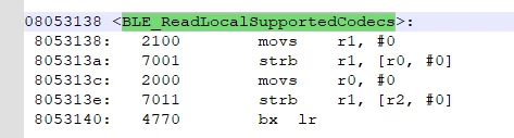

Looking at the assembly code of the project, I noticed a shocking phenomenon: hci_read_local_supported_codecs_v2 is almost empty。 The following assembly code was extracted by me
Fist,  hci_read_local_supported_codecs_v2 store a zero in Standard_Codec and Vendor_Specific_Codec, then call BLE_ReadLocalSupportedCodecs. But BLE_ReadLocalSupportedCodecs has not been made yet, except for assigning values of 0 to Num_Supported_Standard_Codecs and Num_Supported_Vendor_Specific_Codecs.
Did ST not implement this function? Or is there an error in my project configuration?

Jun 7, 2024 2:05 AM UTC
OK, i know now. We need implement BLE_ReadLocalSupportedCodecs to replace the api of ST
