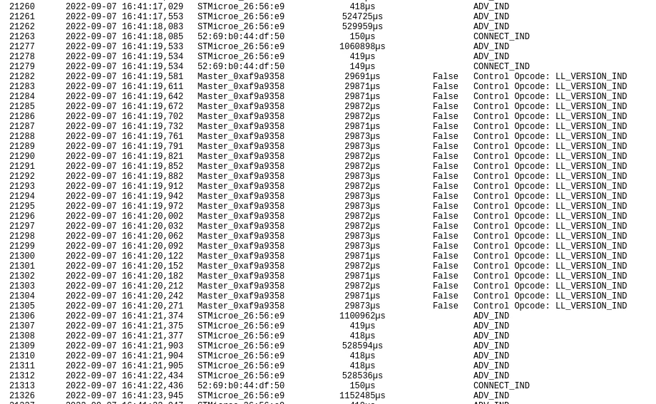

Device not responding to LL_FEATURE_REQ
My custom device with custom firmware don't respond to LL_FEATURE_REQ so the device disconnect.
The connectivity part of my project is very similar to the example BLE_p2p_server, the device start advertising and when I connect to it with the mobile app ST BLE TOOLBOX the connection fail, in wireshark I see the master device is sending LL_FEATURE_REQ but the device doesn't respond.
Can you please help me as I'm stuck for a week now?
I share with you the wireshark logs (remove the .csv extension)
MCU : STM32WB55
Stack: stm32wb5x_BLE_Stack_full_fw.bin v 1.13.1
Thanks by advance for the help.

HSAADI
HSAADIAuthor
Jul 8, 2022 3:52 PM UTC
The issue with the appearance char is resolved, I don't see any other error, but the connection still fail, most of time with error 3E:

Remy ISSALYS
Jul 11, 2022 1:04 PM UTC
The reason 0x3E means Connection Failed to be Established so it's difficult to understand your issue.
Which version of Android or IOS are you using ? And which version of ST BLE Toolbox are you using ? Can you check that you have the latest version please ?
Can you try to perform BLE Air trace to understand the reason of the disconnection ?

HSAADI
HSAADIAuthor
Jul 11, 2022 1:25 PM UTC
I use:
  • HUAWEI P20 android 8.0.0
  • xiaomi MI A2 android 10
ST BLE ToolBox v 1.2.1, on the 2 phones, it's the last version as I know.
I attached the wireshark logs, remove the extension ".txt" added to be abble to upload the file.
In this test I tried multiple times the connection, as you can see the app logs below, the first 5 tries failed with reason 8 then switched to reason 0x3E, After the 3 first tests I reset the device.
I used for this test the Xiaomi phone.

HSAADI
HSAADIAuthor
Jul 11, 2022 3:32 PM UTC
And rarely the device send the response of LL_FEATURE_REQ, I attach wireshark logs
HSAADI
HSAADIAuthor
Jul 11, 2022 3:43 PM UTC
I attach also the logs of the first time that LL_FEATURE_REQ succeeded (remove the .txt extension)
thanks.
Remy ISSALYS
Jul 12, 2022 3:58 PM UTC
Can you try with another smartphone with a newer version of Android like Android 12 ?
Best Regards
HSAADI
HSAADIAuthor
Sep 8, 2022 8:02 AM UTC
Hello, sorry for the late response due to summer vacations.
I don't have a phone with android 12, but I tried with Iphone 12 IOS 15.6.1 and the result is the same:

HSAADI
HSAADIAuthorBest answer
Sep 12, 2022 4:13 PM UTC
Resolved by setting CFG_BLE_LSE_SOURCE to 1 in app_conf.h
