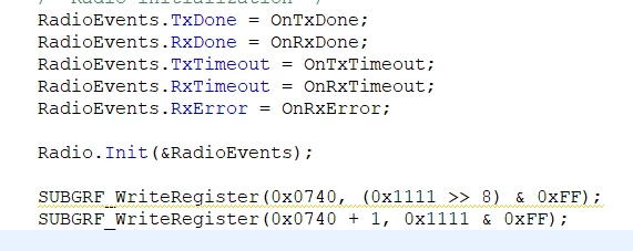

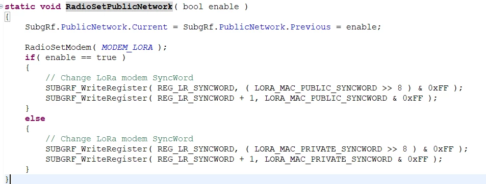

What is the default public network mode in LoRa ping pong example? There is a function of RadioSetPublicNetwork which can be configured, but if we do not configure it at all, what will be the default mode? Public or Private?
Also, how can I set my own private syncword? I thought it doing like this, but compiler is generating implicit declaration error in SUBGRF_WriteRegister() function
Thank you

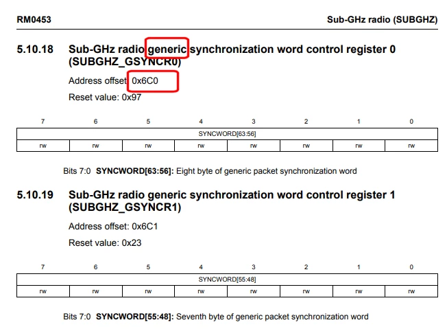

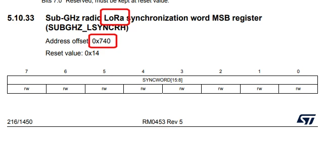

That is what the RM says:

the default network mode in LoRa ping pong example is the LoRa private network.

The Ping-Pong example doesn't use a public network - it's just two devices send messages to each other.
STTwo-32
Jul 10, 2024 4:11 PM UTC
Exactly but the default setting of the SYNCWORD is LoRa private network as indicated on the RM0453.

Thanks for your response, but how can I set my own sync word, default is 0x1424, but let's say I want to set 0x1122, how can I do that? Should I include radio_driver.h file and call SUBGRF_WriteRegister() directly, or there is any other better alternative out there?
