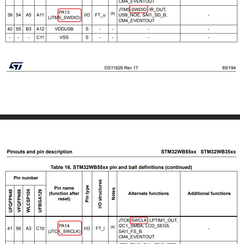

Code is written using stm32CubeMX. Connecting with stmlink V3 Minie.
Executing step by step, it appears that debug fails (lose connection) when executing debug_init. In fact debug_init creates the problem when programming pa13.
When removing the initialization of PA13 and PA14 in debug init, things seems to work but I have no idea of potential side effect.
An recommendation?
Please show that code. See: How to insert source code
PA13 & PA14 carry the SWD signals (ie, the signals the debugger uses to communicate) - so messing with them will break the debugger connection!
https://www.st.com/resource/en/datasheet/stm32wb55rg.pdf#page=65
via: https://www.st.com/en/microcontrollers-microprocessors/stm32wb55rg.html#documentation

Feb 4, 2026 6:26 PM UTC
Please find the app_entry.c generated by CubeMX. Init_debug function start at line 189. On line 208 there is a list of pins to update, Problem occurs when executing HAL_GPIO_Init.
Feb 4, 2026 6:40 PM UTC
Set CFG_DEBUGGER_SUPPORTED = 1 to enable debug support. If this is 0, debug support is disabled and the pins are reconfigured to analog, as you can see in the code.

Feb 5, 2026 6:05 PM UTC
Hello, after your message I look the code one more time and I think you are correct.
My IOC file (see attched) does not contain reference to CFG_DEBUGGER_SUPPORTED .
I tried adding CFG_DEBUGGER_SUPPORTED=1 as the last line of the IOC file (using notepad). I re-open CubeMX and generate the code. Closed CubeMX and reopen IOC file with notepad and noticed that the line i added (i.e. CFG_DEBUGGER_SUPPORTED=1) did not exist anymore.
Looking at the generated code (specifically a #if (CFG_DEBUGGER_SUPPORTED ==1)) is grayed out confirming that the macro is not initialized.
What is the appropriate way to initialise this macro?
You need to do it somewhere in the C source code
#define CFG_DEBUGGER_SUPPORTED 1
