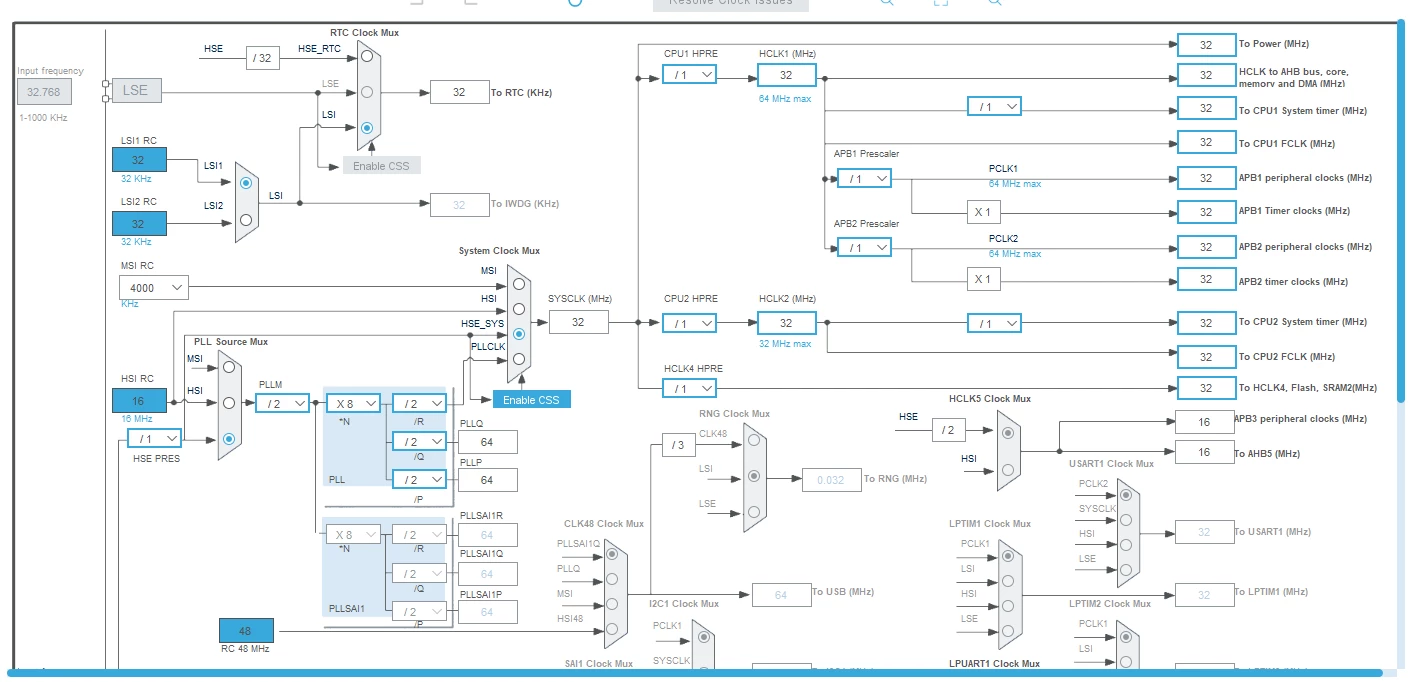

on my custom pcb I have no LSE so I rely on HSE when running and MSI or HSI when in stop or off
when  comparing with BLE HeartSensor reference exemple I dont understand how it keeps advertising when  in STOP mode

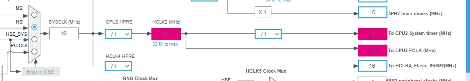

but when switching to HSI sysclk should fall at 16Khz and CPU2 clock too
may be it explain why I can't get advertising when CM4 is STOP in my custom APP but it dont explain why it works on HEARTSensor exemple

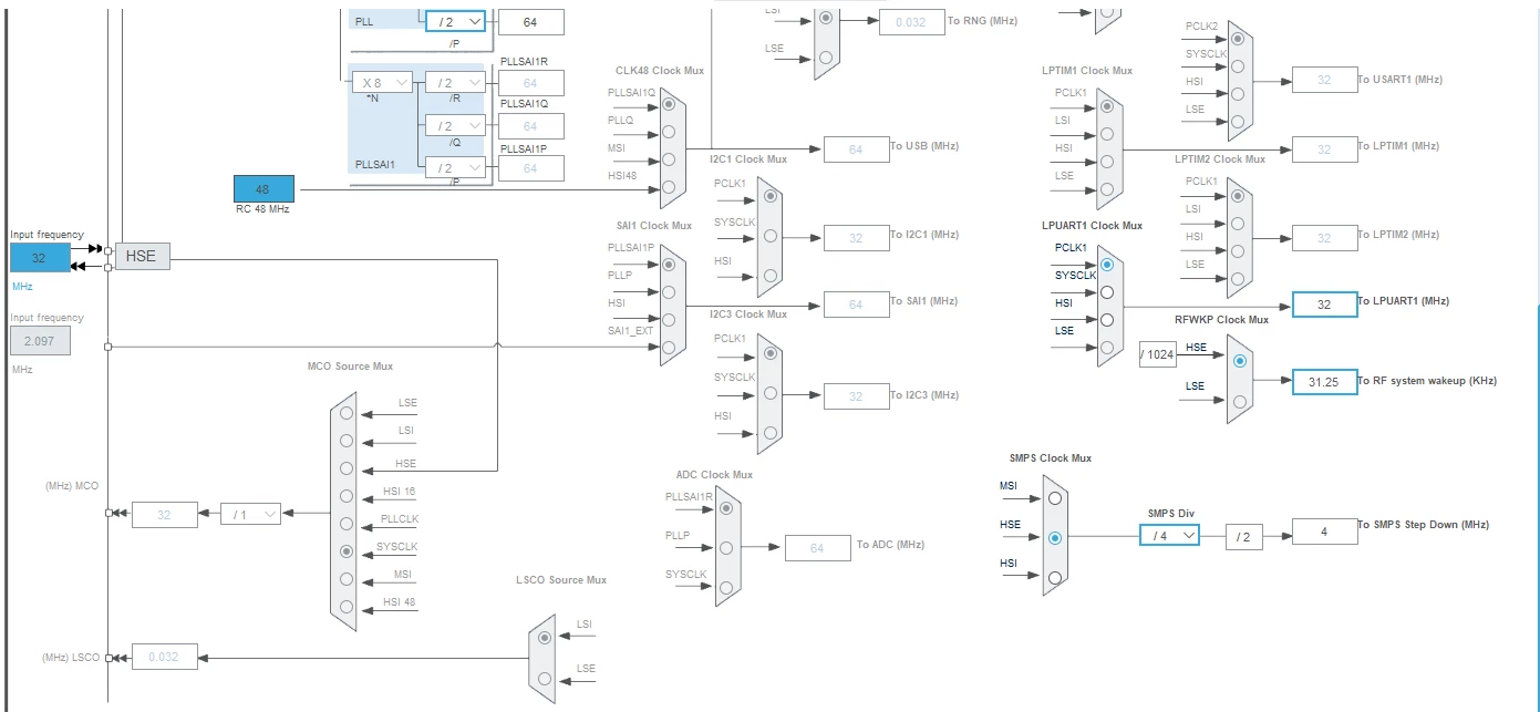

I'm trying to fall into RF interrupt but
My best bet is that : due to pcb size I've no LSE quartz that impose to use HSE/1024 for RF clock
but HSE is not available in STOP2
when looking in ref manual I have 2 interrogations
The functionality in Stop mode (including wakeup) is supported only when the clock is
LSE. When HSE/1024 is selected as RF system wakeup source HSEON bit must be
set by the application.
 The RF system clock is derived (selected by hardware) from one of the two following
sources:
– HSI16 clock
– HSE clock
The functionality in Stop mode is supported only when the clock is HSI16 is selected as
wakeup clock by STOPWUCK.
I dont understand well (sorry I'm not native english speaker) it says that RF wake up in stop mode is only working when clock is LSE and just behind it looks to say that it can be HSE/1024 or HSI16
and when looking into datasheet we can read on p36/37
HSE (32 MHz) automatically used when RF activity is needed by the RF subsystem
I feel a bit confused
