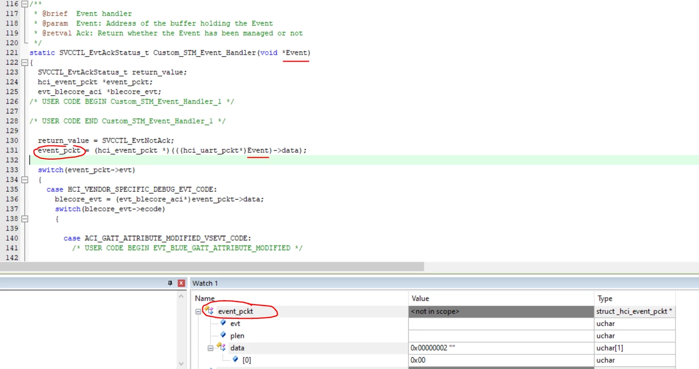

Custom_STM_Event_Handler(void *Event) in custom.stm is not working as I expected to
  • November 22, 2021
  • 3 replies
  • 2186 views

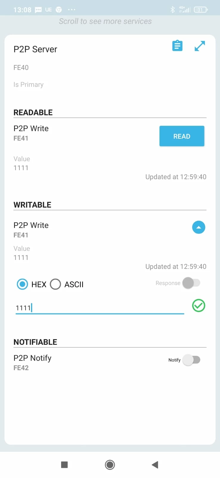

Hello. When I send data from my phone (ST BLE Toolbox App) to my stm32wb55rg nucleo board the code enter in Custom_STM_Event_Handler(void *Event) function in custom.stm. The description of this function sais that the parameter *Event is the location of the buffer of the event. Im sending 0x1111, but when I display the variable event_pkt im not able to see the value i have set or the direction of the memory of the value. Do you know what could happend?

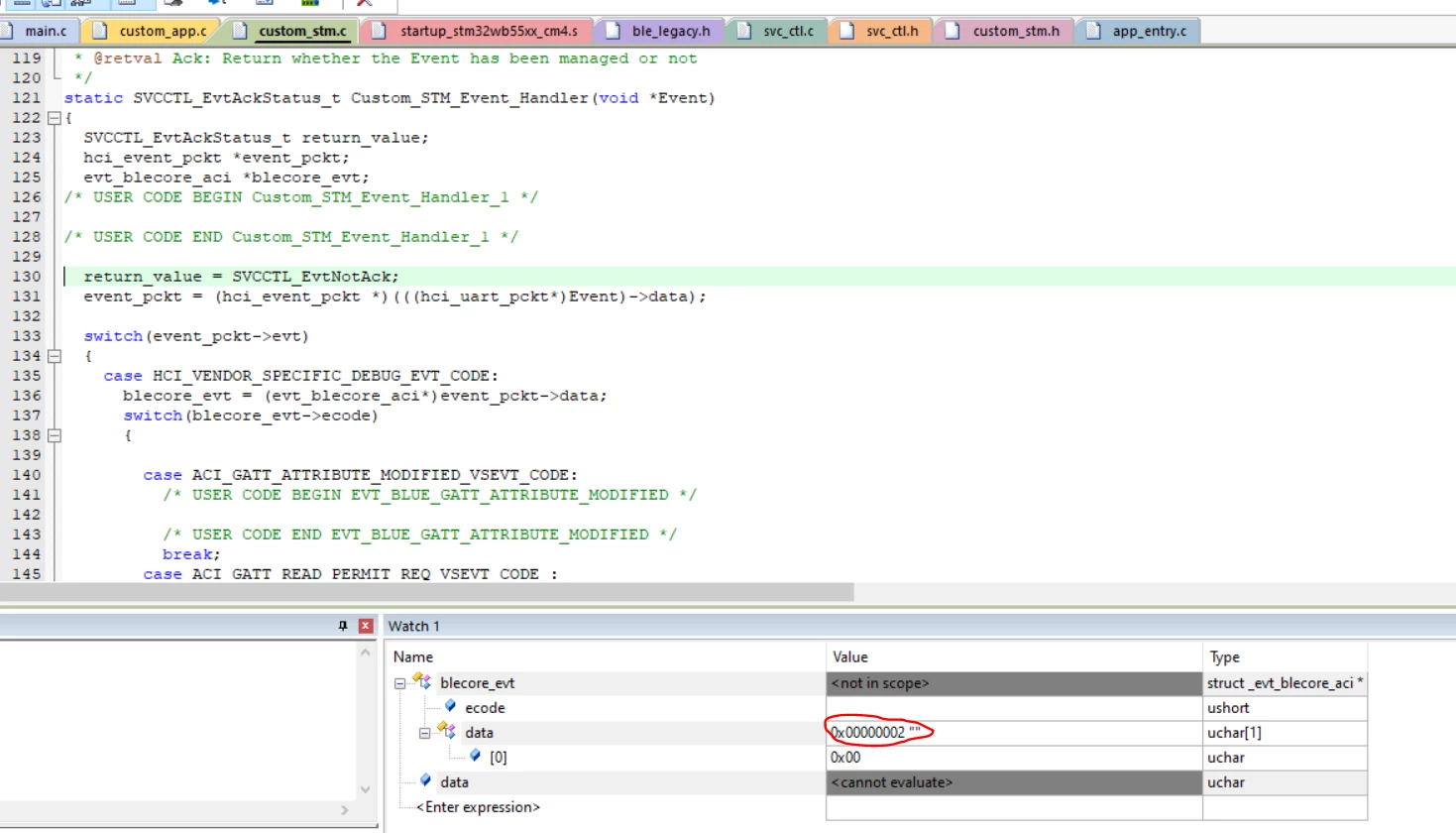

I am using CubeIDE 6.2 , uVision 5.28 and stm32wb55rg nucleo board.

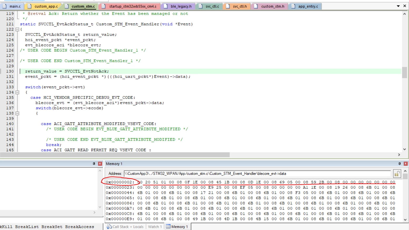

CGali.2
CGali.2Author
November 22, 2021
Hello Imen. I have update the CubeMX to 6.3 version, but I am not able to visualize the data of the event yet. 0693W00000GYQI3QAP.png0693W00000GYQHeQAP.png0693W00000GYQHAQA5.jpg
