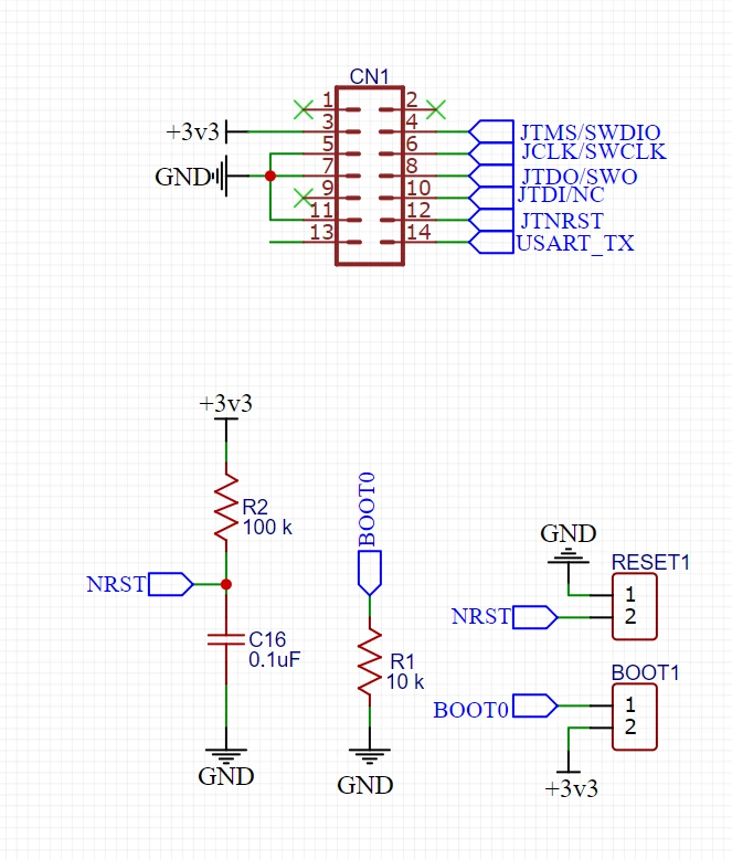

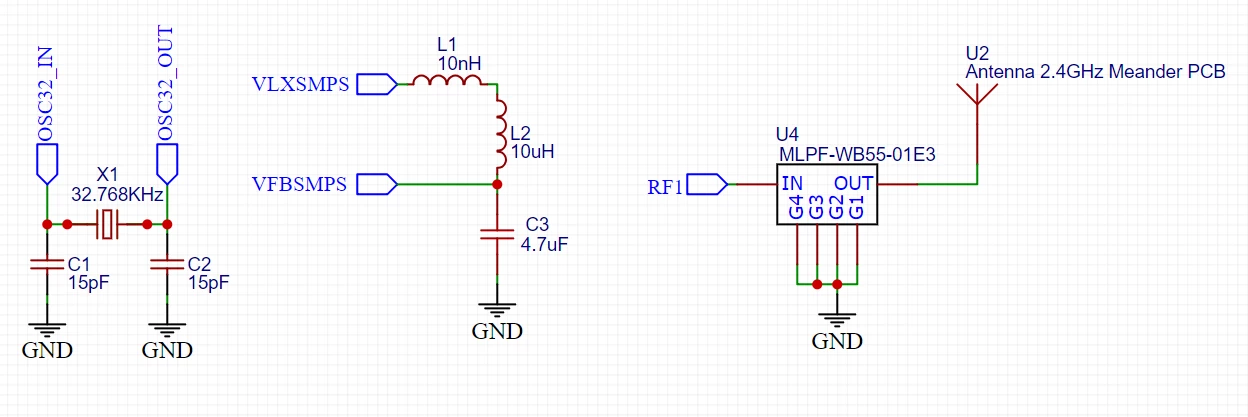

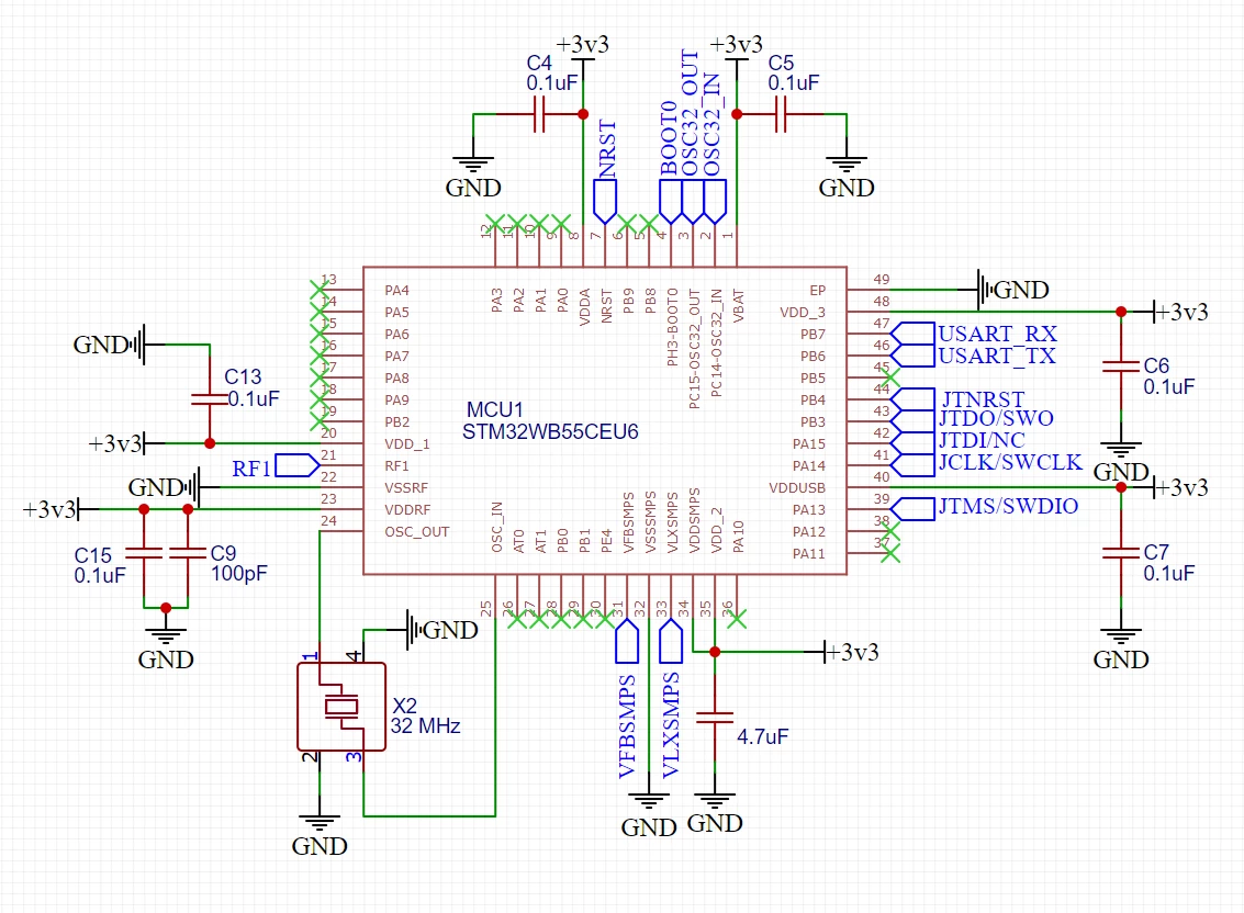

I'm using a custom board based on the STM32WB55CE6U MCU, design using the various application notes and Nucleo-WB datasheet/user manual.

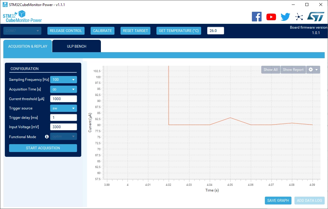

Digging in to the issue I've played around with the simple PWR_STOP2_RTC example, which uses ~3uA on the Nucleo.
Running the same (basically) software on my board, the consumption is never below ~80uA. I've literally soldered off all components but the basics - see pictures.

Just realized my VDDRF was only connected to GND through the decoupling capacitor (was debugging an old board) and not VCC with decoupling... After hooking VDDRF up correctly with some wire, the board now only consumes ~4uA in IDLE-mode running FreeRTOS.
So I guess the answer is that The RF system can run with this wrong configuration, but will draw current!
