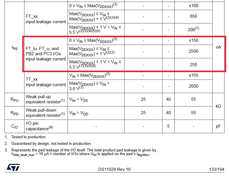

Current consumption of FT pin (error in datasheet?)
is there an error in the datasheet? The data seems counterintuitive:
FT pin input leakage current (max.) is
- 150 nA for 0 to VDD
-2500 nA for VDD to VDD+1V
-250 nA for VDD+1V to 5,5V
Shouldn´t the last value be in uA perhaps?
Kind regards
René

There is no error. it is indeed nA as unit.
The reason of a higher leakage when VDD is in the window VDD max -> VDD max + 1V is the mechanism managing the 5V tolerance of the pin. This mechanism is less optimized in this window than in the window VDD max +1V -> 5.5V where all transistors ensuring the 5V tolerance are well biased, thus generating a lower leakage.
