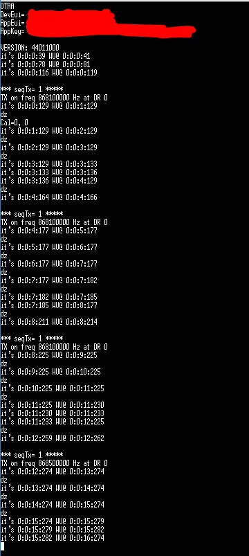

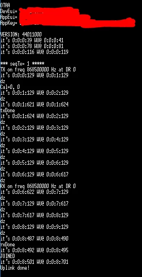

maxence forget
May 19, 2017
Posted on May 19, 2017 at 14:13
With this configuration, the consumption in sleepmode seems to be ok but I can't join my gateway whereas with the JP9 in positon 2-3 I can, there is some modification that I should made?
Thanks in advance
maxence forget
May 19, 2017
Posted on May 19, 2017 at 15:32
I made some screen about my terminal windows in debug and trace with the same code but the JP9 in a different postion:
  • JP9 in position 2-3:
  • JP9 in position 1-2: (impossible to join the gateway)
