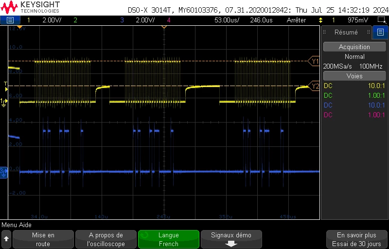

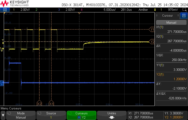

While using SPI1, the clock signal outside communications is at 1.2V instead of th precedent state 0 (0V) or 1 (3.3.V)
as shown in those oscilloscope screenshots:

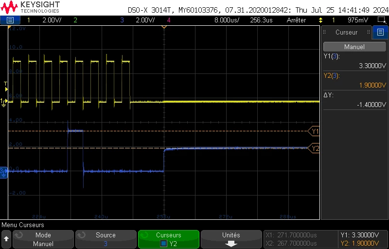

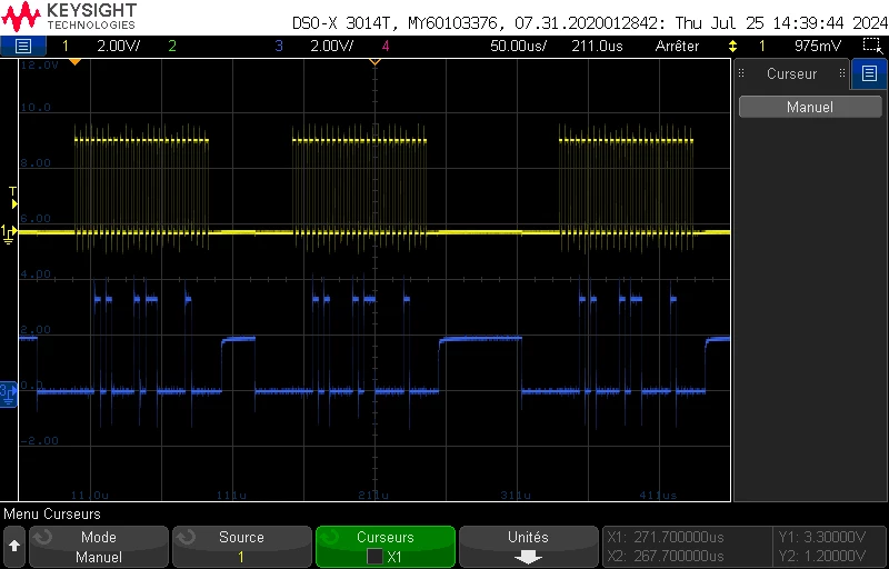

While using SPI3 as I thought it might not show that behavior, another strange behavior appeared, this time on the MOSI signal with a constant voltage when outside com. at 1.9V:

Is this related and is the cause of my lack of com. in my SD card/FileX project, does it have an impact on communication, and is it simply a bug or am I responsible for something?
I tried this with two NUCLEO-STM32WBA52CG dev cards with the same results so far.

Also, I would recommend using pull-up resistors for SPI signals (SCK, MISO, MOSI). This can help ensure proper signal integrity and reliable operation.
