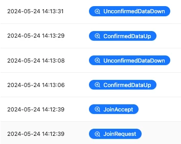

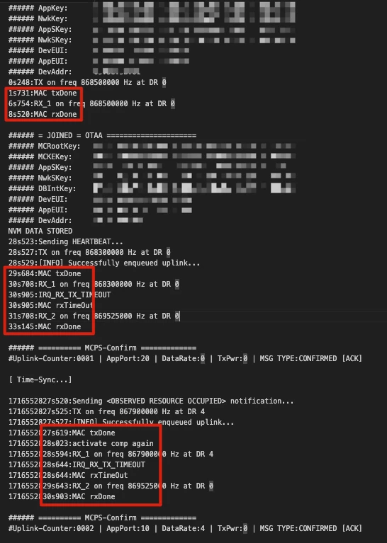

Ok, here's a situation where almost everything worked (OTAA join on first try, downlinks ACKed), but in the first downlink, LNS sets RX delay to 2 seconds, but RX1 is still opened after 1s.
Heres the first UnconfirmedDataDown
Here you can see, OTAA is 5s + 20ms RxError
First downlink is expected 1s + 20ms RxError
Second downlink should be 2s, but is still 1s (strangely MINUS ±20ms RxError?)

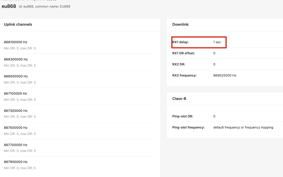

Strangely ChirpStack settings also tell me 1s RxDelay
But in general, RX_1 always times out and RX_2 comes to the rescue, but this should not be the standard behavior I guess...

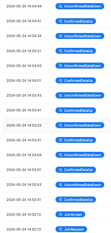

And then there are situations where this goes just on and on with NACKs. OTAA most of the times works after some tries. This is with RSSI ±-60 and SNR of 8.8.
This took 11 tries to get an ACK here...

In LNS, all frames are received and ACKed
Is it possible they are not delivered by the gateway because of Duty Cycle restrictions?
When I try with RAK wireless firmware in same setup, everything works out of the box again...
