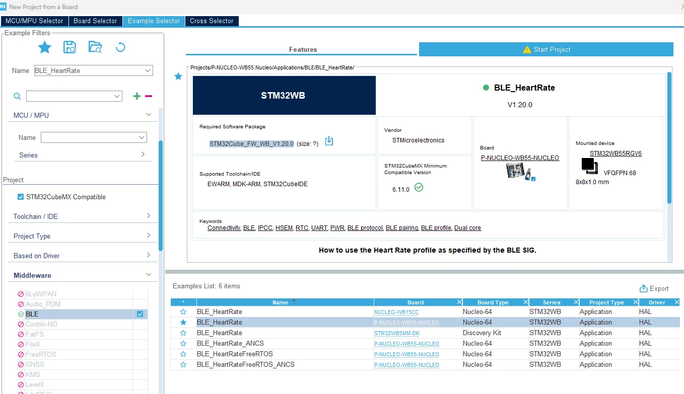

Hello
I have CubeMx v6.11.1.
Am trying to start a BLE_HeartRate project targeting P-Nucleo-WB55-Nucleo, and CubeMx is needing STM32Cube_FW_WB_V1.20.0
This is not available at the ST website. Can you send me this or tell me how to create this project using V1.19?
Thanks.
Giri

The issue has been fixed. Please try again on your side (don't forget to login to Your CubeMX so it can update his files).

Can you give me the version of the CubeIDE/MX that you are using. As a temporary workaround, you may open your project directly from the STM32CubeWB/Projects at master · STMicroelectronics/STM32CubeWB (github.com) after downloading it from the ST Website (V1.19.x). I don't have this issue on my side using the CubeMX V6.11.1.

CubeMX v6.11.1
Cube iDE v1.15.1,  Build 21094_20240412_1041
Steps I took.
Example Selector Tab --> BLE_HeartRate --> P-NUCLEO-WB55-NUCLEO
As the picture attached last time shows the V1.20 need under Required Software Package.

I'm able to reproduce this issue on my side using on the same environment. I've escalated to the concerned team for more investigation (under internal ticket number 184419).
