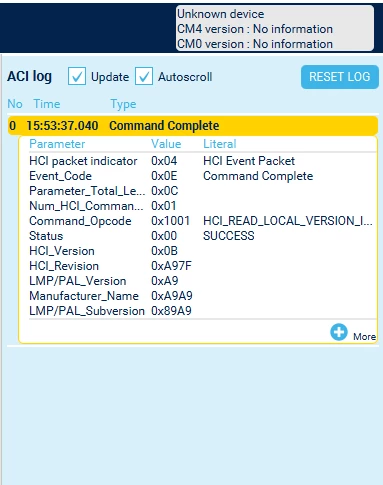

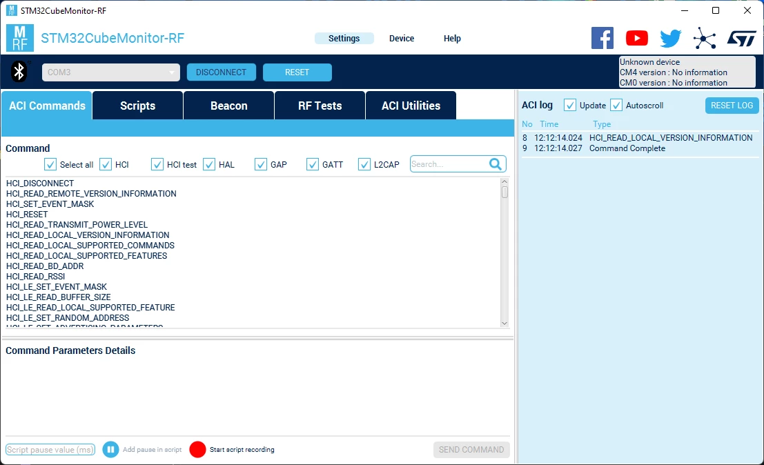

CubeMonitor 2.9.0 freezes after connection and does not read device
I just updated the CubeMonitor/CubeIDE/CubeProgrammer to the latest versions.
After doing this my old version of Transparrent Mode (for STM32WB10) does not compile anymore.
After creating a new project, and getting it to compile and run. I can now connect to my device through CubeMonitor-RF... sort of.
It reads the version information and reports "Command Complet" but it says
Unknown device
CM4 version: No information
CM0 version: No information
and when I try to read the HCI_READ_RSSI, the program freezes completely.
The following screenshot is just after connecting.
0693W00000QKw03QAD.pngI can debug the code and pause the execution, but it is not in any fault handler.
What can be wrong??? It was working under the last version

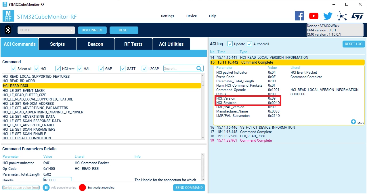

Hello Ugilten,
The FW10.0.1 should work in STM32CubeMon-RF V2.9.0, sorry for this drawback. In my side the FW1.10.0.1 is working (STM32WB55), please can you check the HCI_VERSION and the HCI_REVISION value.
HCI_VERSION = 0x09
HCI_REVISION = 0x004D
0693W00000QKwsyQAD.pngBest regards,
Christophe.

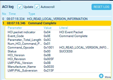

I just tried again this morning and now I got a different HCI_Revision (0x005F)
Ugilten
UgiltenAuthorBest answer
Jul 13, 2022 7:01 AM UTC
I found the fault... The Serial2USB converter I was using was not wired correctly, causing the uart communication to crash 🤦�?♂�?
I still think it is weird that it does not recognize the device and the CM4/CM0 versions... But that I can live with as long as the rest is working :beaming_face_with_smiling_eyes:
