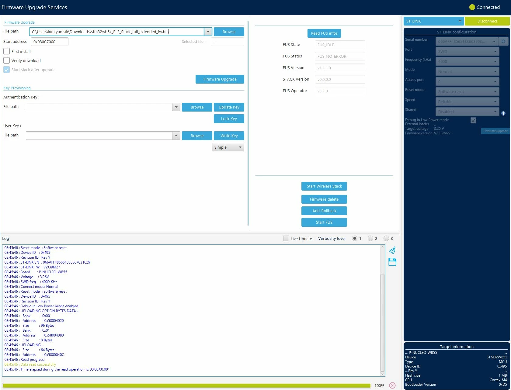

I'm using a custom board with STM32WB55CG. When I uploaded my custom BLE program with STM32IDE, the program could not work. Then I found the chip had an error with FUS and wireless stack. When I read the FUS info, the fus version was v1.1.1.0 and the stack version was v0.0.0.0. 0693W00000NsKFuQAN.jpg​
When I push the Start Wireless Stack button, the error with FUS_STATE_IMG_NOT_FOUND was occurred.
Then I tried to upgrade FUS with stm32wb5x_BLE_Stack_full_extended_fw.bin(Release v1.13.3) and encountered with the problems. I tried the upgrade with cubeProgrammer v2.10.0, v2.9.0, and v2.8.0, and it returned the same results.

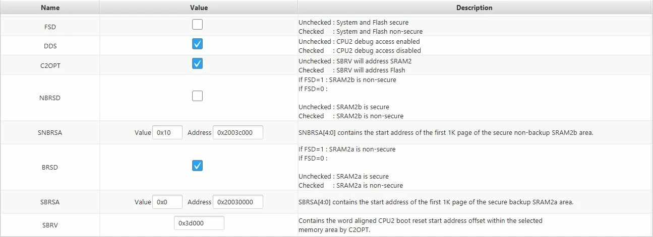

Also, I found some strange things at option bytes. The SNBRSA and SBRSA have different values and addresses from NUCLEO55USB-DONGLE. Here is the picture.
​0693W00000NsKGxQAN.jpg​Any suggestions to fix this issue ?​

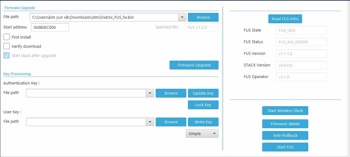

After and before the upgrade the fus infos was as following picture.

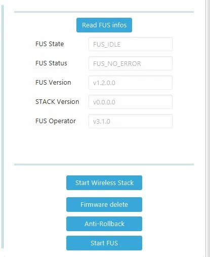

I followed your advice and upgraded FUS to v1.2.0 successfully.
0693W00000NsLq3QAF.jpgHowever, when I tried to upgrade BLE stack, the following error was occured.
