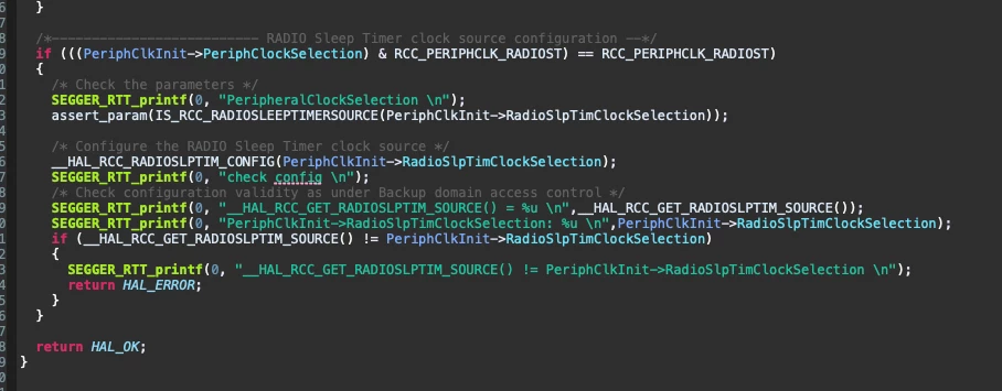

Im using my own costum board with a STM32WBA52CG on it. When I'm nog using the RF my code is working perfectly. When I activate the RF in the STM32CubeIDE, my code is stuck in  PeriphCommonClock_Config();
More specifically in the following code:
I already checked my HSE crystal and I'm getting 32 MHz out. So what could be wrong? because without the RF I'm not able to use BLE..

I did not attach the antenna yet, thats why it got stuck on that line!
