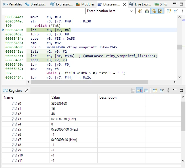

Core M0+ (STM32WL55) - apparent wrong execution of a machine instruction?
While debugging an application on the M0+ core of a STM32WL55JC device, the debugger showed what appears the incorrect execution of an ARM machine instruction.
The codesnippet at the beginning of the execution is shown in Image #1:
(the original C code compiled is a trivial "switch" section, but this is irrelevant)

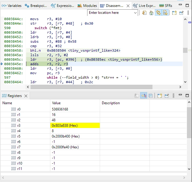

0693W00000LwFzsQAF.pngEverything proceeds as expected until the instruction shown in Image #2.

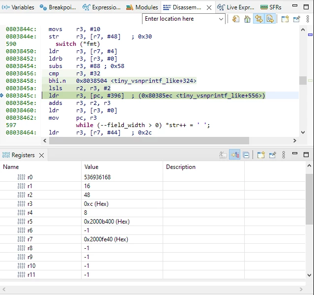

The execution of the "ldr   r3, [pc, #396] " instruction @0803845c, however, seems to yield an incorrect result (as shown in image #3):
expected -> r3 = 0x80385ec (as also reported in the comment placed by the compiler)
obtained -> r3 =  0x803a868

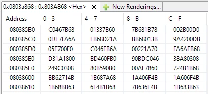

0693W00000LwFzxQAF.pngFrom the memory dump (image #4), the opcode of the instruction appears to be correct according to ARMv6-M Architecture Reference Manual (DDI0419D_ARMv6-M_arm.pdf), section A6.7.27, p. A6-127:
0x803845c -> 63 4B (= 4B63)
01001 LDR <Rt>, [PC, #<imm>]
011 <Rt> = R3
01100011 = 99; <imm> = 99*4 = 396
(you have error in the line above, r3 is 0x803a838 as witnessed by the screenshot)

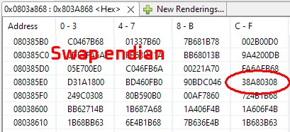

The [] indicates indirection, i.e. that instruction should load into r3 *content* of 0x080385EC - and it indeed does:
Giocc1
Mar 30, 2022 12:59 PM UTC
@waclawek.jan Of course you are absolutely right, that's what I missed. Thanks for responding (and so quickly too)!
