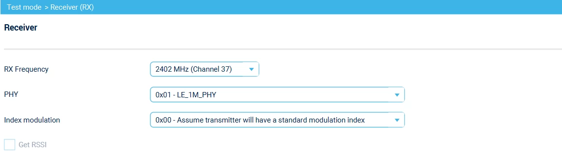

I'm using the board STM32WB05KZ and i installed STM32CubeMonitorRF to connect to the baord (Mode BLE)
But i received a notification that i can't connect to the board

Could you please try to follow those steps:
  1. Upload the BLE_TransparentMode.hex to your board.
  2. Open the STM32CubeMonitor-RF PC tool and set the com port to the one of your board.
  3. Set the baudrate to 921600
  4. Click on Connect.
That should work fine.

ljmAuthor
Mar 12, 2025 8:37 AM UTC
Hello
thanks for relying
it works thank you very much.
one last question please here why "Get RSSI" is locked ? i want to get the RSSI value
thanks
