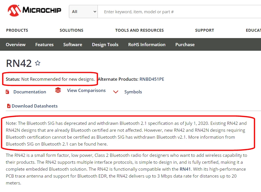

Andrew Neil
Mar 26, 2024 10:11 AM UTC
Isn't the RN42 "classic" Bluetooth - not BLE ?
:thinking_face:
Note that RN42 is Not Recommended For New Designs (NRND) as it cannot be certified for new products:
