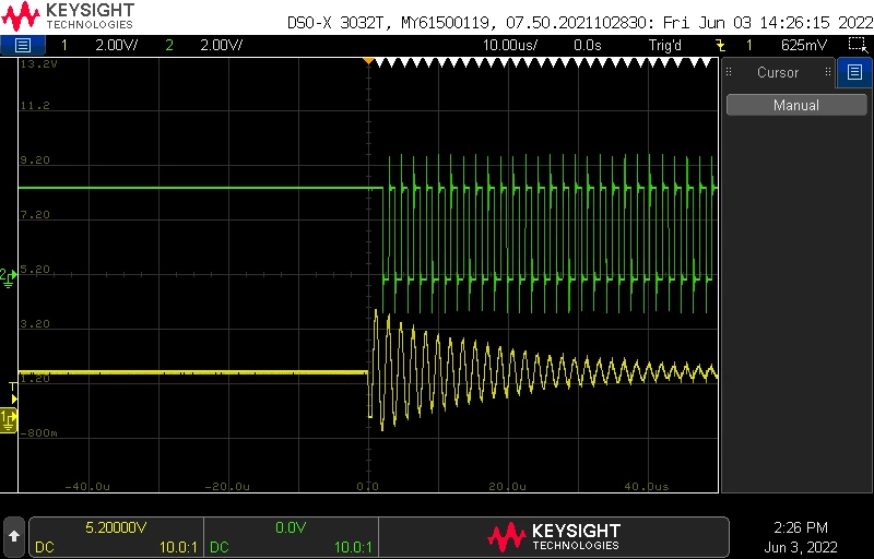

I discovered a problem with the STM32WLE5CCU6 using the comp1 on stop2 mode.
More specifically, when the debug is enabled on stop2 mode using the command HAL_DBGMCU_EnableDBGStopMode() the comp1 is working and I get all the peaks of the oscillation (see image 1). But when I make a single change, and disable the debug on stop2 mode, with the command HAL_DBGMCU_DisableDBGStopMode() the comp1 stops counting all the oscillation peaks (see image 2).

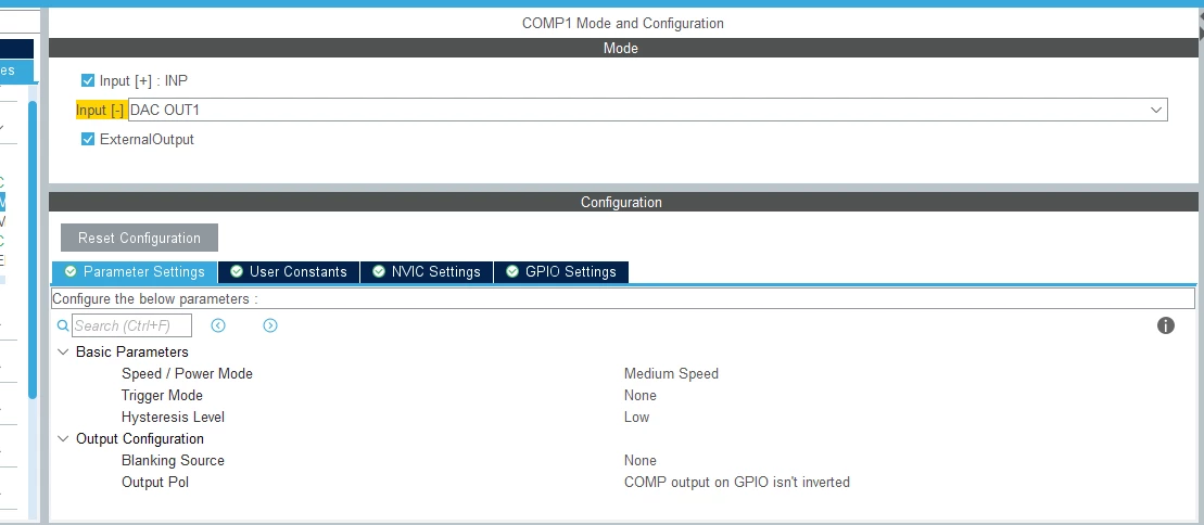

The yellow is the oscillation and the green is the external gpio output of the comparator (see Image 3)
I'm not sure if this is a hardware problem or software. Please make your tests and report back.
In the datasheet it isn't clear if on stop2 mode the comp1 data registers are retained, but from the results it seems that they do. Also I have tried to reinitialize the comp during stop2 exit but i get the same results.

If you refer to RM0461, Table 37, you can see that COMP1/2 is one of the peripheral which will continue to operate normally even in STOP2 mode. This means that :
  • retention is not applicable, as the block operates normally
  • behavior is the same in DBG_STOP = 0 or DBG_STOP = 1
Can you precise which GPIO you use for you input (yellow) and for your output (green) ?
Thanks,
Benoit

I'm using the STOP2 mode.
GPIO PB4 for COMP1 input. (yellow).
GPIO PA0 for COMP1 External output (green).
In the STOP2 mode the DAC that i'm using is not retained. If the DAC OUT1 Mode lost then the comparator use false values on Input [-]
But the DAC looks ok.
