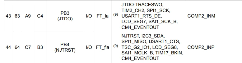

I am using comp2 for our project ( STM32WB5MM )were we use INP Plus and INP Min Pins for the comperator,
for INP plus I Use the PB4 and For INP Min i want to use the Pin PB3 or PB7 but unfortunately I am not getting interrupt at disered voltage, but if I just change INP Min Pin to PA4 everything works properly and i don't understand why its working for only PA4 pin and not for others...

Hello @VJani.11
According to the datasheet, after resetting, these pins are configured as JTAG/SW debug alternate functions, and the internal pull-up on PA15, PA13 and PB4 pins and the internal pull-down on PA14 pin are activated.
