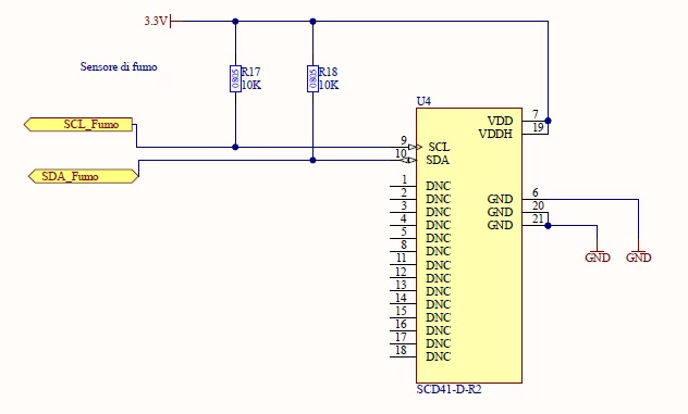

communication with sensor: scd41-d-r2
Good evening, I ask for help regarding the communication between stm32wb5mmght6tr and the scd41-d-r2 sensor.
I connected the sensor to pins PC0 (SCL) and PC1 (SDA) and powered the sensor but after loading the code I attach, the i2c communication gives me an error (they don't communicate). I checked the address of the sensor and it is correct and also the connections. Anyone know what it could be? Thank you in advance.
circuito di connessione del sensorecircuito di connessione del sensore
Codice:

#define SCD41_ADDR (0x62 << 1) // Indirizzo I2C del SCD41
// Comandi SCD41
#define SCD41_CMD_START_MEASUREMENT 0x21B1
#define SCD41_CMD_READ_MEASUREMENT 0xEC05
extern I2C_HandleTypeDef hi2c3; // periferica I2C utilizzata
// Funzione per iniziare la misurazione del SCD41
void SCD41_Start_Measurement() {
uint8_t cmd[2] = {SCD41_CMD_START_MEASUREMENT >> 8, SCD41_CMD_START_MEASUREMENT & 0xFF};
HAL_I2C_Master_Transmit(&hi2c3, SCD41_ADDR, cmd, 2, HAL_MAX_DELAY);
