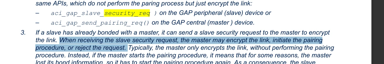

Client side following a security request
When a peripheral sends an aci_gap_slave_security_req() what event does it generate on central side?
Asking it as central has the option to:
Encrypt link . "the master may encrypt the link", which command does that?
Pairing proc init "initiate the pairing procedure", which command does that?
Reject "or reject the request". which command does that?
I am following PM0257:

Hello @DS.4
When the central receives the slave request, its stack sends "pairing request" and the exchange to follow is the same as if the pairing is initiated by the central. It means the pairing process is started. With this configuration, the central will receive an ACI_GAP_NUMERIC_COMPARISON_VALUE_EVENT to which it answers with ACI_GAP_NUMERIC_COMPARISON_VALUE_CONFIRM_YESNO.
Best Regards.

What are the conditions to each may ?
Are those configurations on the master side done before ?
Or some consideration on previous info on master side?
Please do elaborate!
STTwo-32
May 31, 2024 8:14 AM UTC
The Best way to have the necessary explanation on this is to take a look at the part 2.4.6 of the Vol, Part H of the BLUETOOTH CORE SPECIFICATION Version 5.4.
