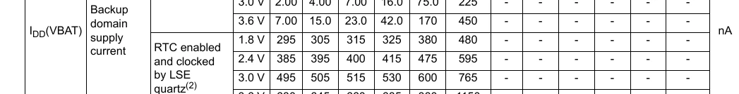

AScha.3
AScha.3Best answer
Aug 4, 2025 9:27 AM UTC
>Did you check whether setting the drive strength to max
To be true : never.
Measuring drive level ...is not easy:
https://www.allaboutcircuits.com/technical-articles/measuring-drive-level-of-a-quartz-crystal/
So i never worried about the drive level, but having a not starting or stable running oscillator,
IS a big problem: it stops the whole machine .
So ( at work ) i defined: we use hi drive always, to have no machines not working, because the LSE stopped working.
And now thousands of boards running around the world (many since years 24/7 ) and no problem with the clocks.
About the drive level /power at your WB55 ...see ds, power... , without any measurement :
So it consumes typ. 500nA at 3 V , = > 1.5 uW ;  what can it drive now "dangerous power" to the crystal?
assuming a 50% efficiency , all is 0.7 uW , thats possible at its max. "power" ....come on. Dangerous ? Joking, eh ? :)

AScha.3
AScha.3Best answer
To be true : never.
