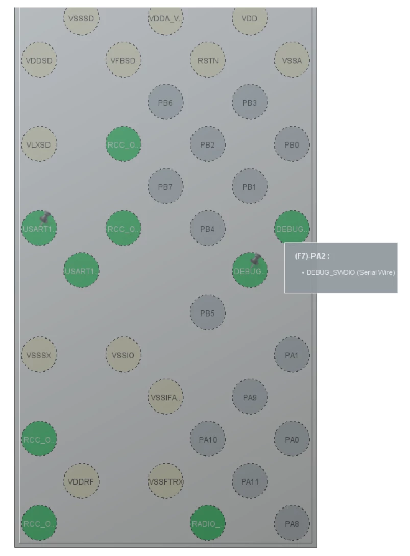

Hi,  I'm developing my custom board using STM32WB09TEF7TR Microcontroller but have a problem during Programming using STM32cubeIDE.
I can access the memory of this microcontroller using STM32CubeProgrammer through SWD protocol.
However, once I try to import my code to the microcontroller using STM32CubeIDE, the importing fails with error message below.
Break at address "0x100017d0" with no debug information available, or outside of program code.
Log output file: C:\Users\GGKIM\AppData\Local\Temp\STM32CubeProgrammer_a31344.log
ST-LINK SN : 0037002F3532510631333430
ST-LINK FW : V3J15M7B5S1
Board : STLINK-V3SET
Voltage : 3.30V
Error: ST-LINK error (DEV_TARGET_RESET_ERR)
2nd connect tentative with frequency (8MHz)
Voltage : 3.30V
Encountered Error when opening C:\ST\STM32CubeIDE_1.17.0\STM32CubeIDE\plugins\com.st.stm32cube.ide.mcu.externaltools.cubeprogrammer.win32_2.2.0.202409170845\tools\bin\STM32_Programmer_CLI.exe
Error in STM32CubeProgrammer
Shutting down...
Exit.
Do you have any idea why it happened?
I also checked the option byte of this microcontroller. There is only one option byte, RDP. it was FF which means that anybody can do programing.
In addition, I want to try to import my code using the STM32cubeProgrammer by making a bin file from IDE. However, I don't know the starting address.
Does anybody know the starting address for manually importing a code using cubeProgrammer?
FYI, I can see the memory address from 0x10040000 to 0x100BF800, which means 0x100017d0 is outside of memory.

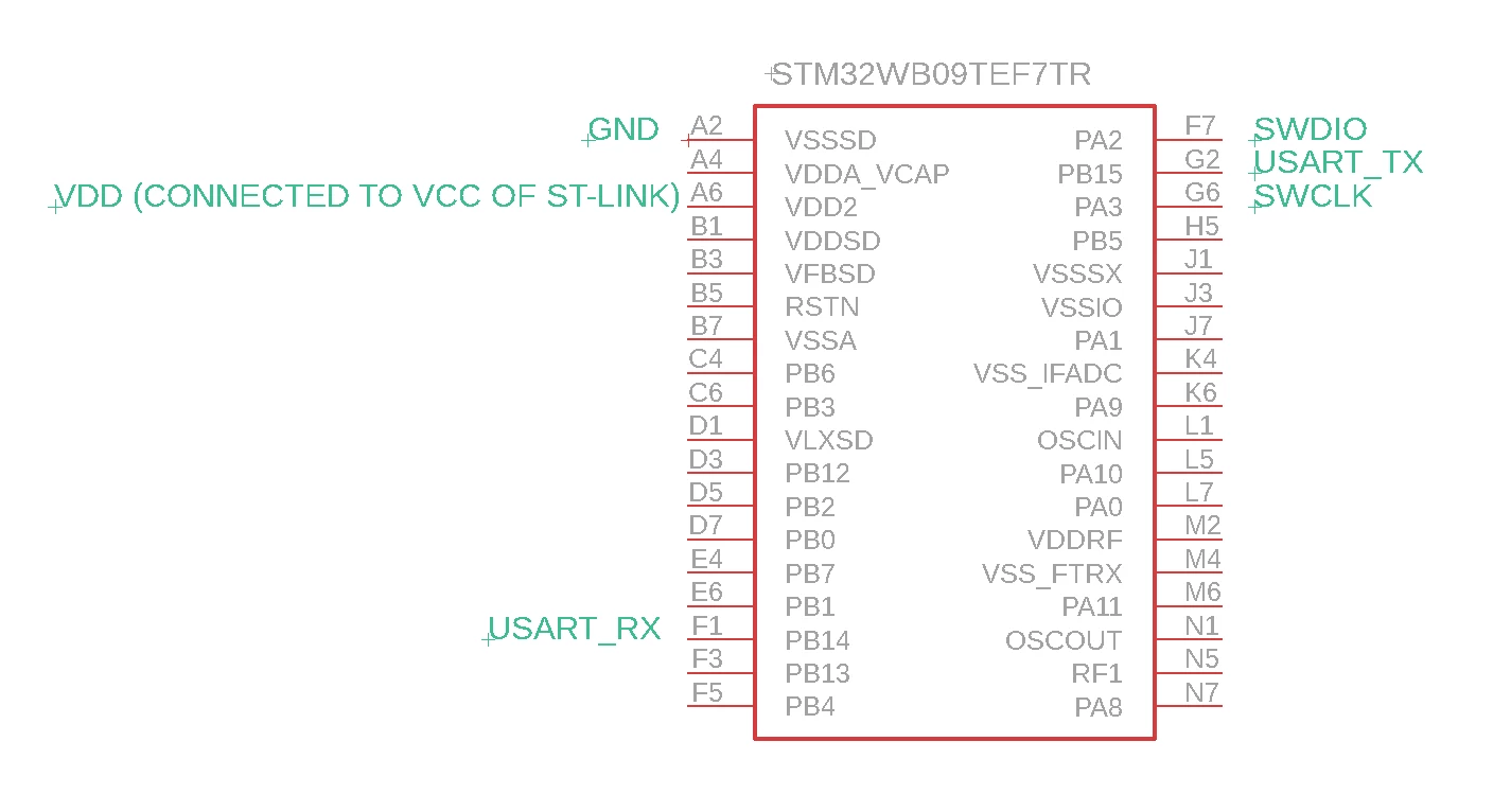

Could you please share the schematics of your board and the connection with your ST-LINK.
Best Regards.
STTwo-32
KKIM.6
KKIM.6Author
Senior
Jan 10, 2025 3:39 PM UTC
This is all I can share. Unfortunately, I'm not suing RST (B5) pin of this microcontroller.
STTwo-32
STTwo-32Best answer
Jan 10, 2025 4:11 PM UTC
This is the same behavior mentioned on the previous link. The RSTN pin should be linked to the NRST pin of your ST-LINK.
Best Regards.
