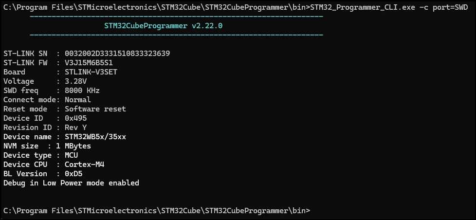

Here the CLI log from my STM32WB55CG (Nucleo-WB55 USB dongle):
Please, share a picture of the marking on your device package.

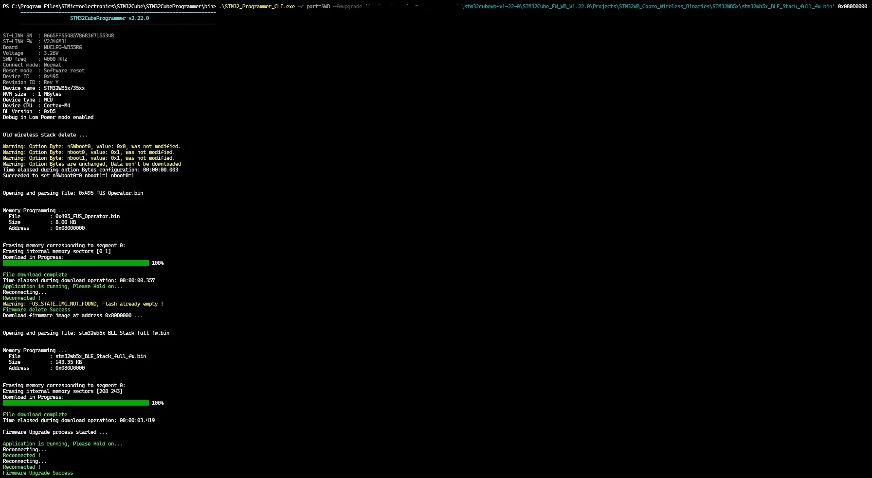

Below dfu-util log of download test (not OpenBL) above 0x08080000:
In order to be fully aligned on the setup, please consider to share your code.

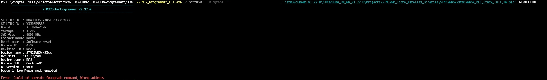

Something interesting. When programming through CLI. uC info is wrong:
Says that CG has 512KB of NVM when it has 1MB:

Feb 25, 2026 3:17 PM UTC
My bad, we bought a STM32WBCE. Big mistake.
Thank you for your time.
