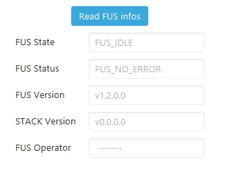

0693W00000SwMRHQA3.pngFYI - I have successfully been able to upgrade the FUS version with no issue:
0693W00000SwMRqQAN.pngI attach the logs for both the Wireless stack fail and the chip mass erase fails.

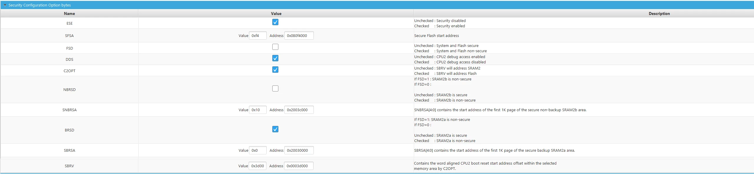

Regarding the option bytes, just do a screen shot of the secure ones. That should be enough.

Here's a copy of the log in verbosity 1 as well as a picture of the secure bytes:

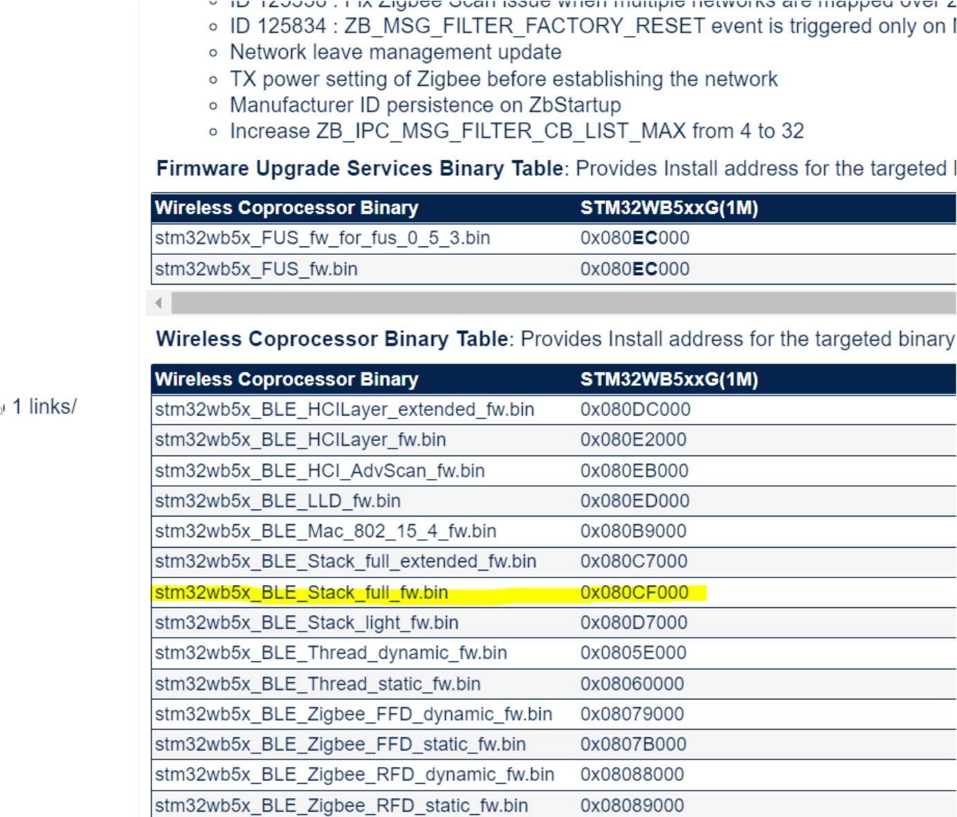

Does this solution mean that the address given in the documentation (release notes) is just wrong? This is what I was working off of:
Device info:

En effet c'est étrange. quelle est la version de WB FW package utilisez vous? V1.13.x ou v1.14.0?
MSuva.1
MSuva.1Author
Sep 28, 2022 3:02 PM UTC
Apologies, it seems I was reading the V1.14 notes but trying to flash the V1.13 binaries. Thanks very much for your help I think this is closed now :)
