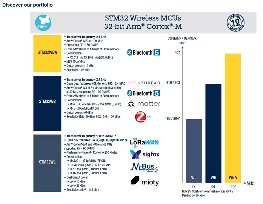

I'm looking for a wifi opencpu soc with 2*UART and I2C with SD card support.Can you Please sugggest me an IC

St doesnt have any soc supporting Wifi that i know of
https://www.st.com/en/microcontrollers-microprocessors/stm32-wireless-mcus.html
